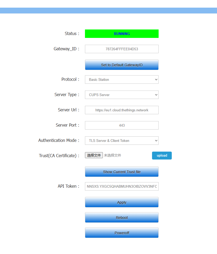

Configuring Gateway
Go to the Gateway configuration page.
Reference linking: HT-M02 Quick Start.
Choose
Basic Station
The remaining options are defined as follows:
Server TypechooseCUPS Server.Server URLFill in your server address, the format shoud be like “https://eu1.cloud.thethings.network”.Server PortFixed port443.Authentication ModechooseTLS server & Client token Authentication.Trust (CA Certificate)The default is TTS official CA CertificateClient TokenEnter the CUP keys generated by the server.
Click
APPLY, andReboot. After some minutes, go back to the server web page, where you can see that the gateway already works as a Basic Station.
