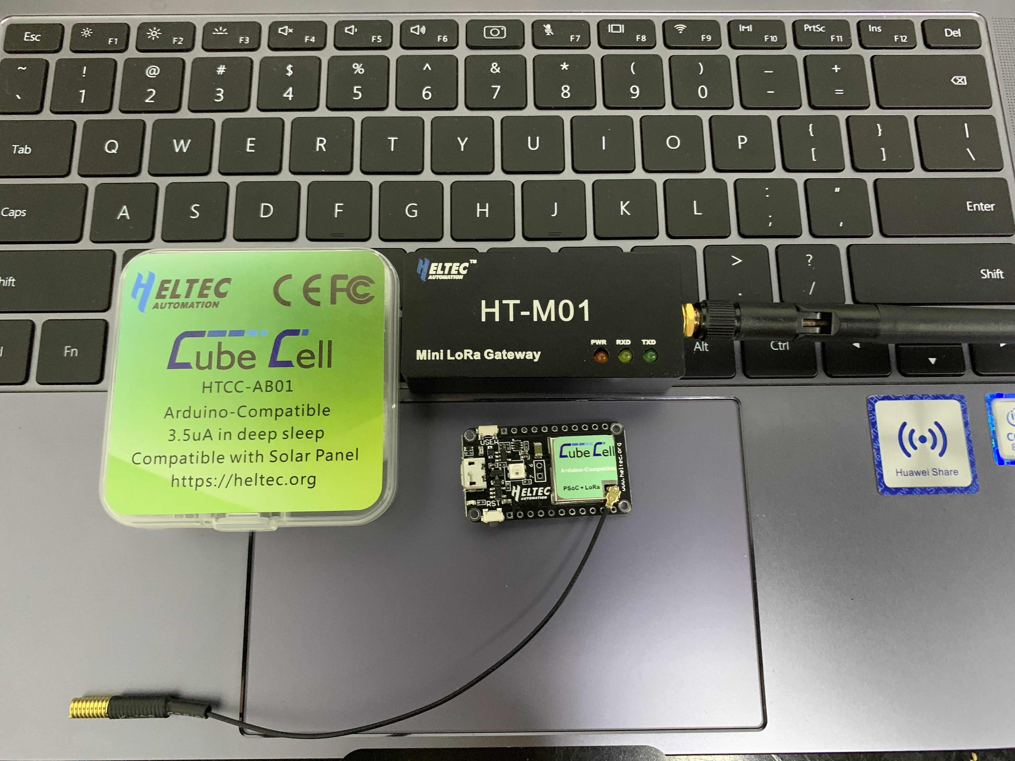

In this example, we use HT-M01 Mini Gateway in Windows® 10. Test band: EU868, others working band is similar.
