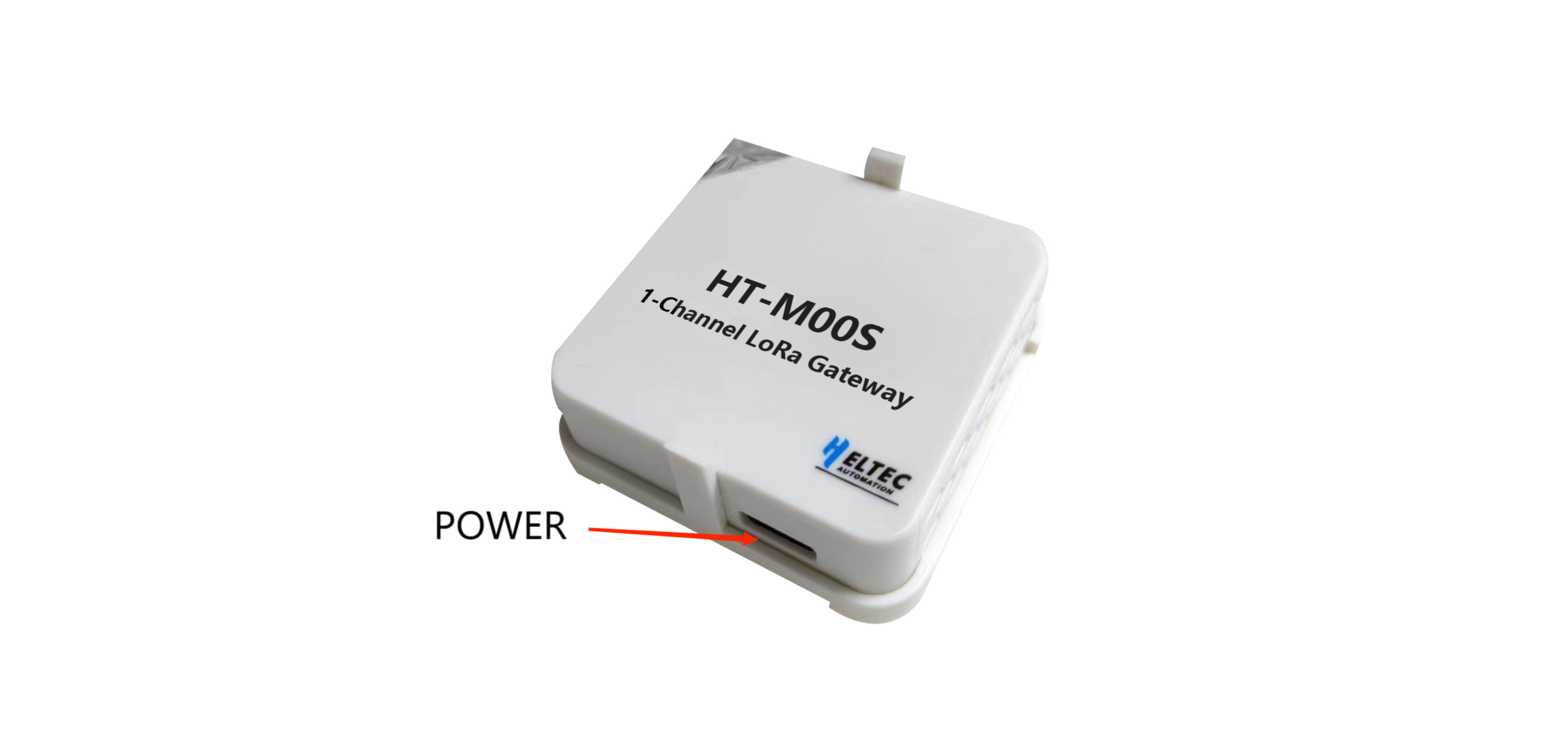

The HT-M00S is powered by 5V DC, and the interface is USB Type-C.

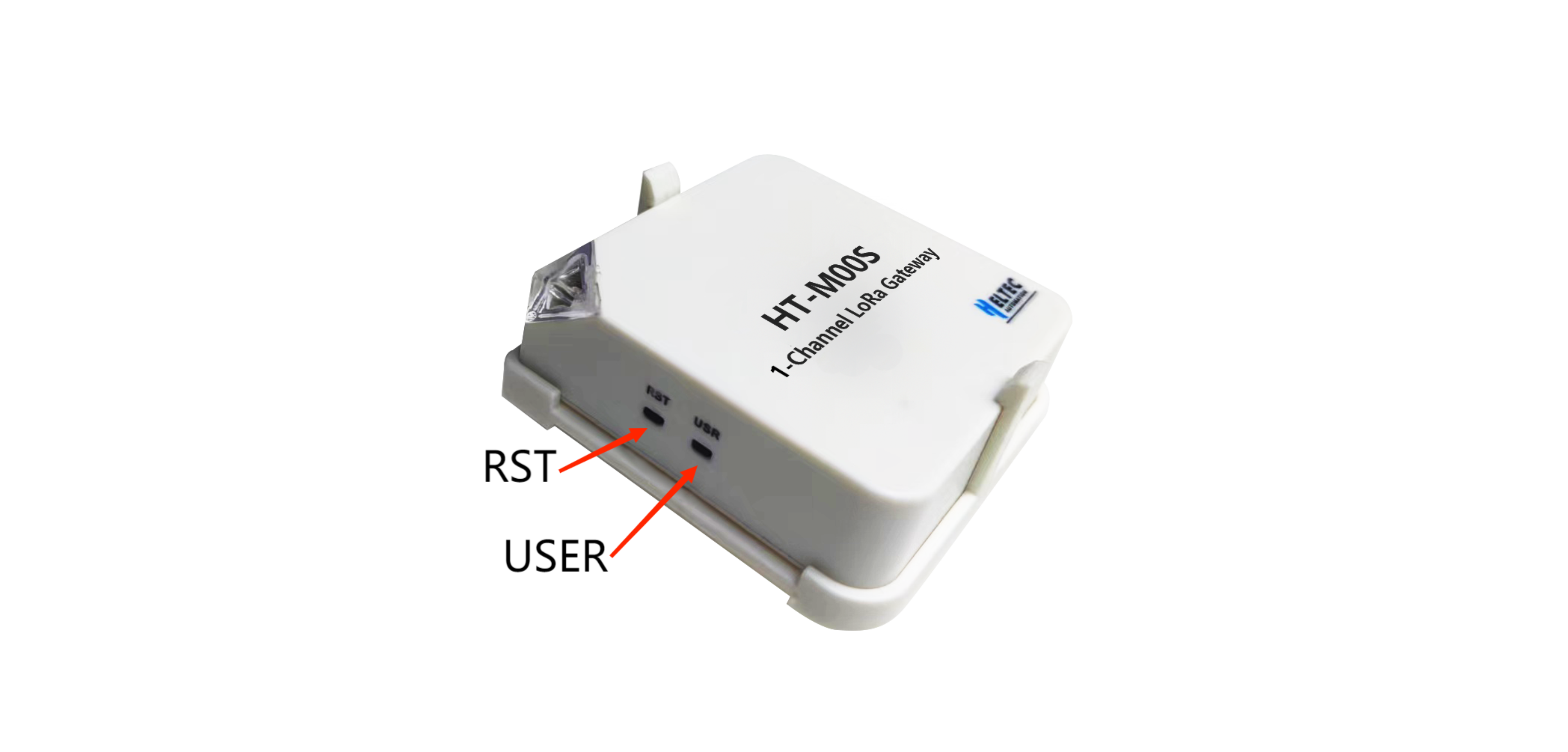

After the device is powered on, long press the USER key until the device RGB changes to yellow, and release the key.

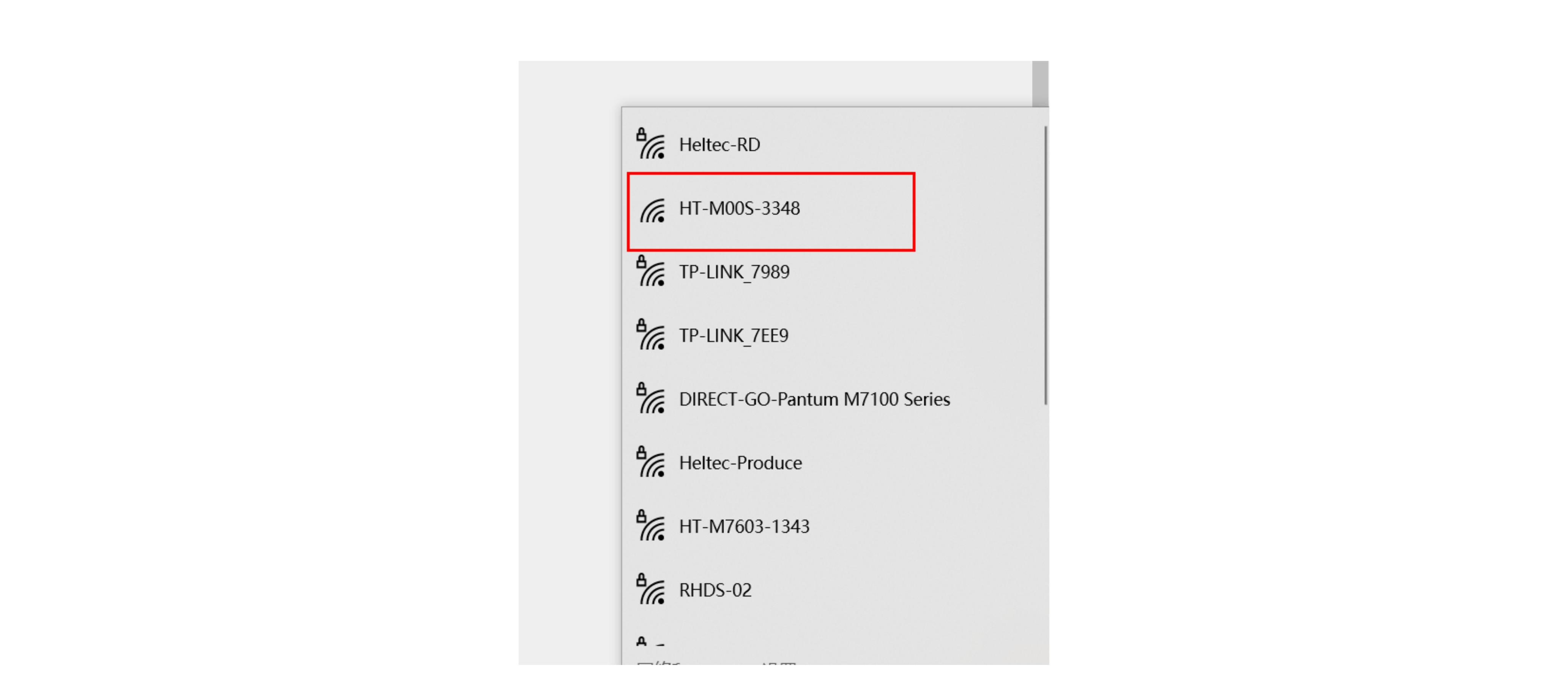

At this time, find the WiFi named HT-M00S-XXXX through PC or mobile phone , and connect to this WiFi.

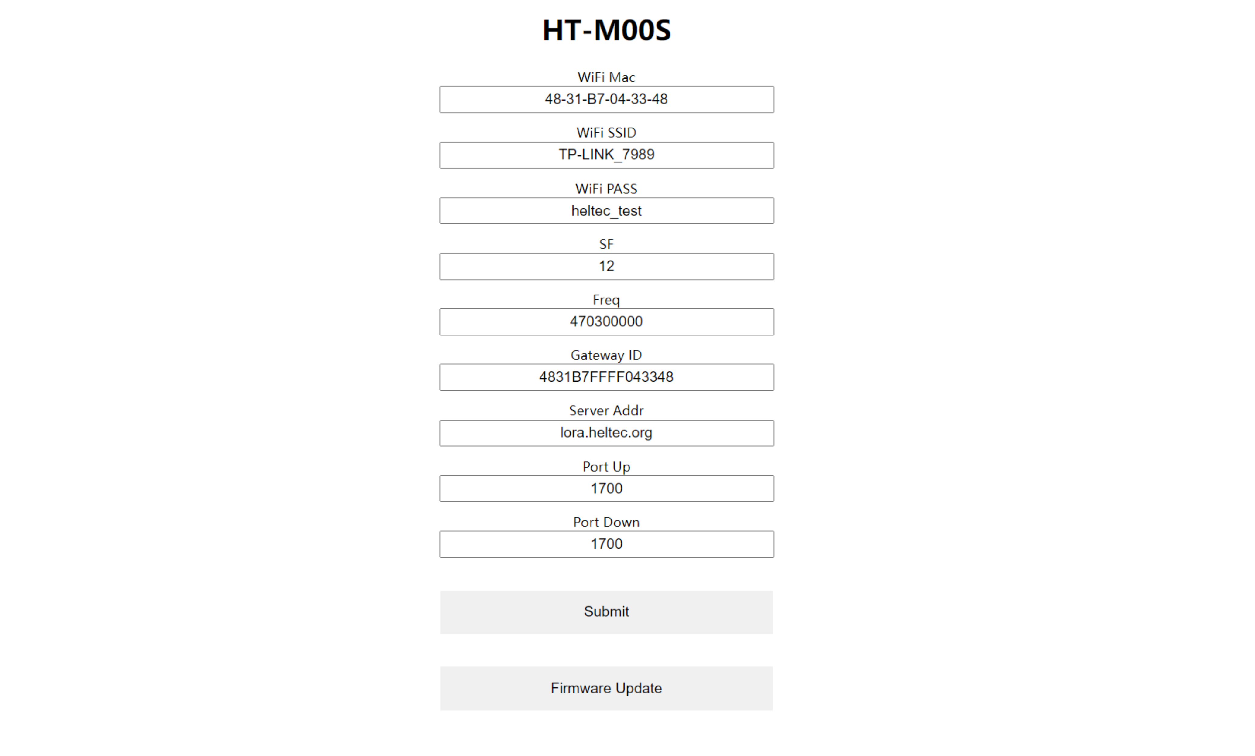

After connecting to WiFi, enter 192.168.4.1 in the browser and enter to enter the configuration page.
The configuration page parameters are defined as follows:
  • WiFi-MAC MAC address of HT-M00S;
  • WiFi-SSID The WiFi account connected to the network;
  • WiFi-PASS The WiFi password connected to the network;
  • SF Spreading factor, match with a node;
  • Freq Transmitting frequency of gateway LoRa, it must be a frequency point, such as 470300000, which means 470MHz band / 0 channel;
  • Gateway ID The ID of the HT-M00S, used for server registration;
  • Server Addr HT-M00S needs to connect to the server address;
  • Port up Port down Server uplink and downlink ports;
  • Submit Submit when the configuration is complete;
  • Firmware Update OTA update.
