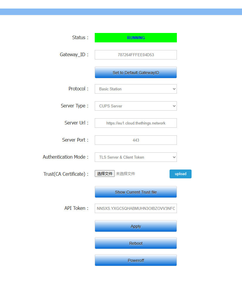

Configuring Gateway
  1. Go to the Gateway configuration page.
    Reference linking: HT-M02 Quick Start.
  2. Choose Basic Station
The remaining options are defined as follows:
  • Server Type choose CUPS Server.
  • Server URL Fill in your server address, the format shoud be like “https://eu1.cloud.thethings.network”.
  • Server Port Fixed port 443.
  • Authentication Mode choose TLS server & Client token Authentication.
  • Trust (CA Certificate) The default is TTS official CA Certificate
  • Client Token Enter the CUP keys generated by the server.
  1. Click APPLY, and Reboot. After some minutes, go back to the server web page, where you can see that the gateway already works as a Basic Station.
