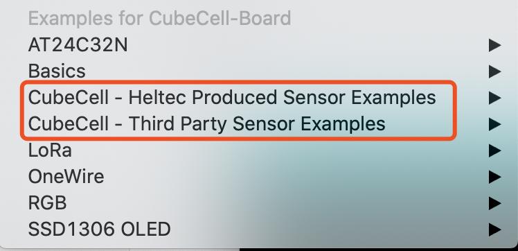

In the example menu CubeCell - xxxx Sensor Examples, is the basic test program used by capsule sensors, which can be used to quickly verify the sensor and read the value from sensors:
Heltec Produced Sensor Examples: Sensor modules made by Heltec. Sensor List: https://github.com/HelTecAutomation/ASR650x-Arduino/blob/master/libraries/SensorBasic/readme.md
Third Party Sensor Examples: For third-party sensor modules developed by users. Sensor List: https://github.com/HelTecAutomation/ASR650x-Arduino/blob/master/libraries/Sensor_ThirdParty/readme.md
