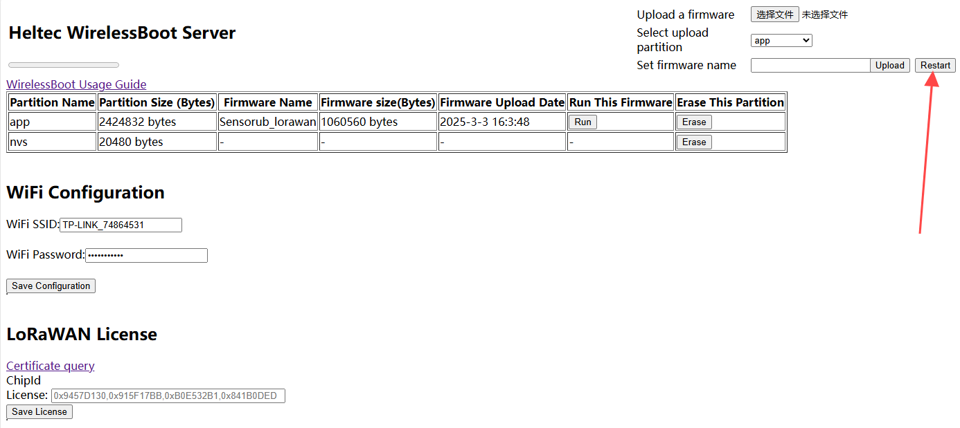

In your browser, enter “192.168.4.1” and use the default password “heltec.org”.
This is the interface for uploading firmware via WirelessBoot.

You can configure the WiFi address on this page. After “Save Configuration”, you can access the WirelessBoot mode through the device’s IP address without needing to connect to its WiFi.

Navigate to the WirelessBoot page, choose the corresponding firmware,select an APP partition, and click “Upload.”
Note
The firmware name should not be too long; otherwise, it cannot be uploaded.
After the upload is successful, click “RUN” to confirm which program you want to execute.
Click “Restart” to reboot the device and start its operation.
