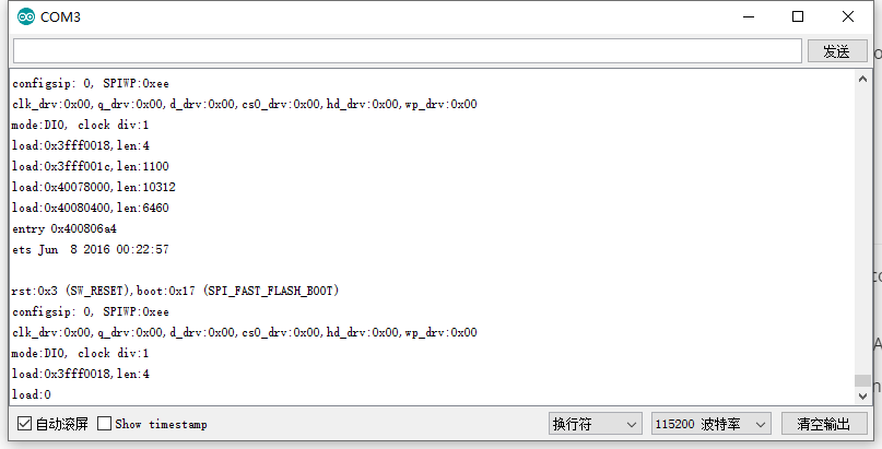

System Reset All the Time
According to the situation we have collected so far, the most likely to cause a constant reset problem may have two reasons:
  • Power supply problem: please make sure the voltage of USB ≥ 4.7V, 300mA;
  • You chose an error board: because each type of board may have a different FLASH size, and they have a different partition map, it will cause the internal logic error.
