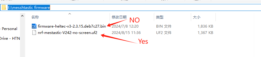

  1. Download the firmware you need to run to your PC.
Tip
The format of the file should be “xxx.uf2”.

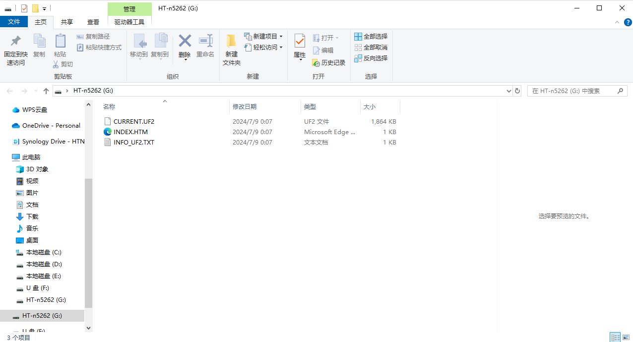

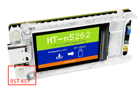

  1. Connect T114 and PC Via USB cable. Press the RST key twice in quick succession.
  1. At this point, the PC desktop will pop up a device named “HT-n5262”.

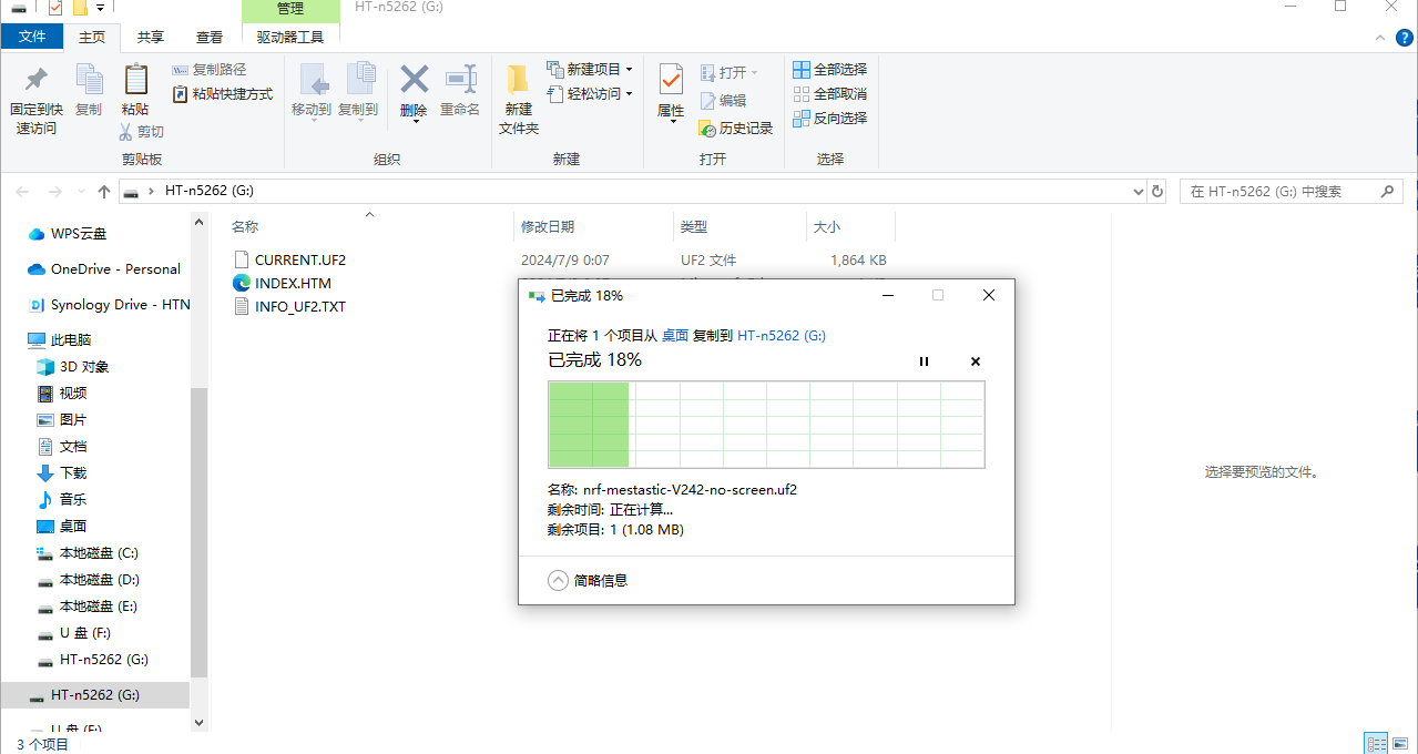

  1. Copy and paste the prepared firmware into the device.
  1. After the transfer is complete, the device will automatically restart and run the new firmware.
