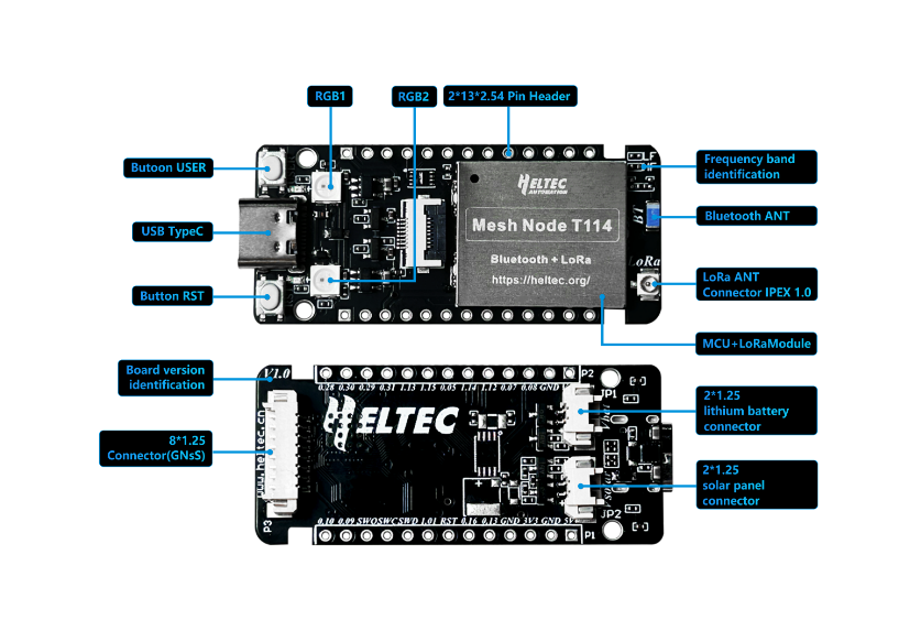

Hardware Update Logs
V1
  • First release
  • 2024-8-7 public sale
V2
  • The circuit board was changed from 4 layers to 6 layers so that both the RF part and the crystal oscillator part can obtain a more complete ground.
  • The circuit was changed from lead-free to immersion gold process, which is more friendly to signal transmission.
  • The position of some components was adjusted.
  • The RF path was optimized according to the six-layer board structure.
  • The direction of the 2.4GHz Bluetooth antenna and IPEX LoRa antenna interface was changed to make them farther away.
  • Now the high-frequency Mesh node T114 can stably send long data packets in the “Long_Fast” channel of Meshtastic.
