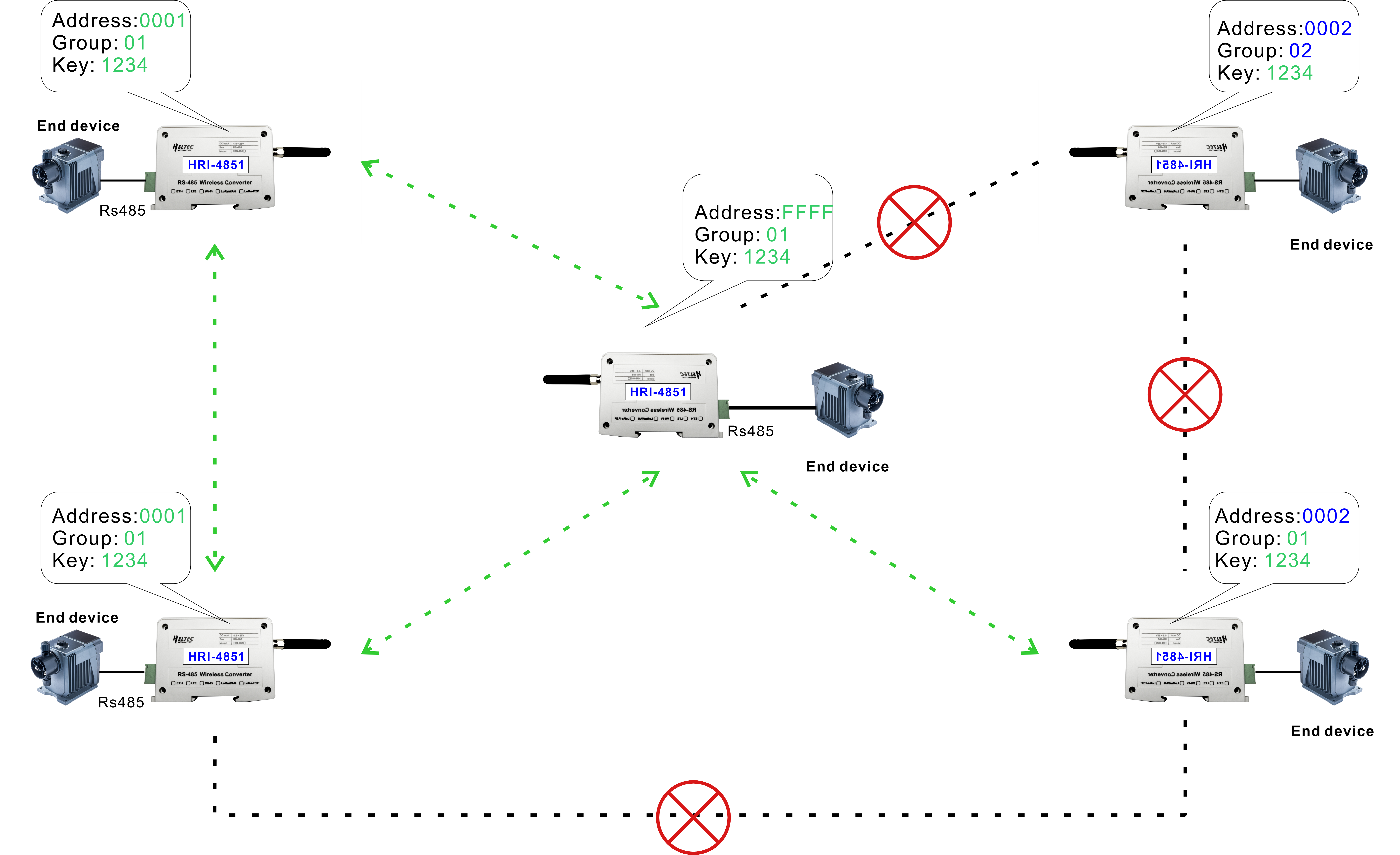

HRI-4851+HRI-4851 P2P/P2MP
HRI-4851 is connected to the RS-485 terminal, and the received RS-485 signal is forwarded with LoRa signal to realize point-to-point or point-to-many communication of different devices.

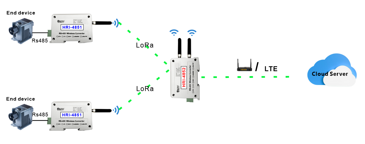

HRI-4851+HRI-4852 Connect to Server
On top of P2P/P2MP, if you also need to send incoming messages to the server, you need to use a combination of HRI-4852 + HRI-4851.
备注
HRI-4852 is usually only used as a tool for HRI-4851 to enter the network. HRI-4852 cannot connect directly to the RS-485 device.

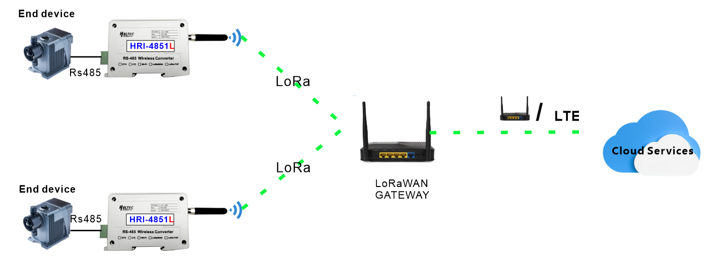

HRI-4851L + LoRa Gateway
The device connect to the HRI-4851 via RS-485, HRI-4851 sends data via LoRaWAN to the gateway, gateway sends data to the LoRaWAN server.

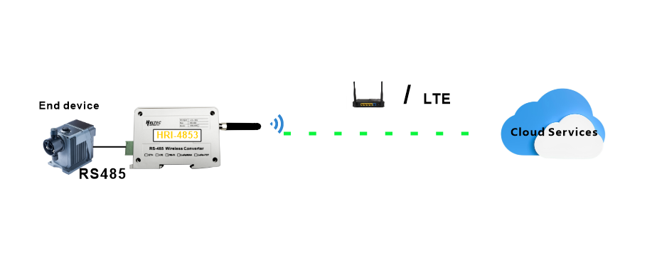

HRI-4853 Node to Server
For occasions where LoRa is not needed, HRI-4853 directly forwards the data from the RS-485 terminal to the server.

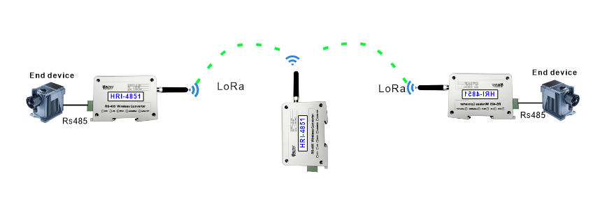

HRI-4851 Relayer
hrough the relay function of HRI-4851, the communication range of HRI-4852 or HRI-4851 can be greatly extended.

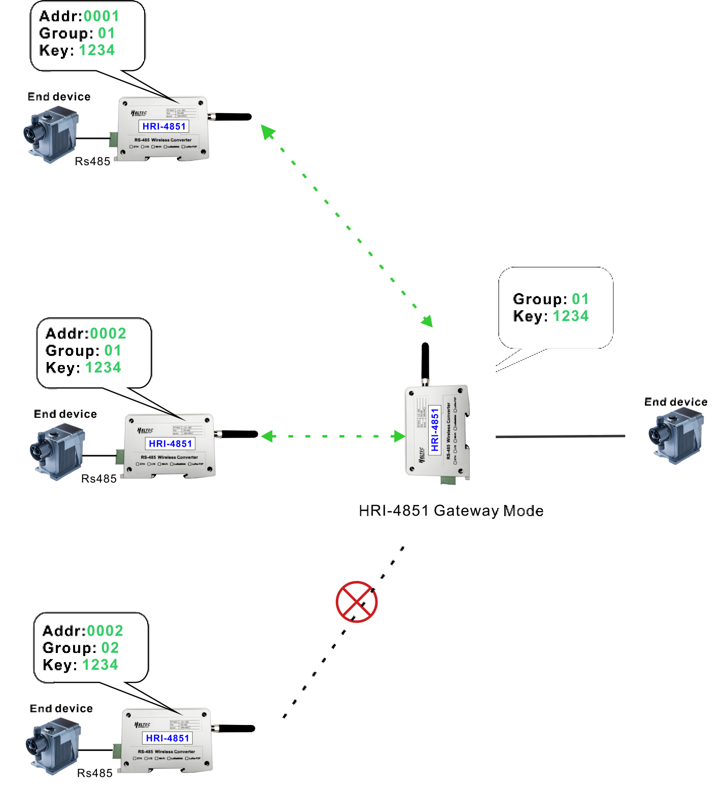

HRI-4851 Gateway
LAN Gateway functions, for example, if one of your terminals needs to receive HRI-4851 data from a different address, you can run the gateway function of HRI-4851.
