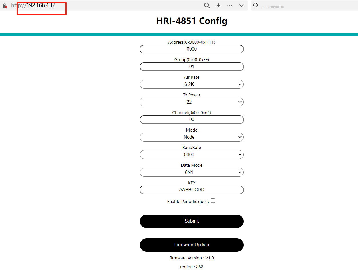

  1. Press the RST button, until the white LED flashed quickly, at which point the device enters the configuration mode.
  1. In configuration mode (White LED flashed quickly), you can find HRI-485x’s Wi-Fi, in general, it has the format”HRI-4851L-xxxx”, connect to this WiFi.
  1. Enter 192.168.4.1 through the browser.
警告
Note that if you have just configured another device, don’t just refresh ‘192.168.4.1’, you should retype it.
Configure

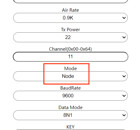

  1. Enter the configuration page, under the Mode option, select Node.

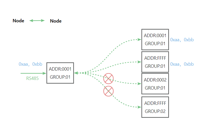

  1. In general, HRI-4851 with the same Lora Parameters, Address, Group, Key can communicate with each other.
备注
‘BaudRate’ ‘Data Mode’ should be consistent with the terminal device.
小技巧
When the Address is FFFF, the device communicates with a device of any address(Group still has to be the same)
  1. By clicking the Enable periodic query option, you can set up to 10 polling commands, and when multiple commands are run at the same time, they will be executed automatically at five-second intervals.
  1. Click Submit when the configuration is complete.

Data Format
As shown above, HRI-4851 with the same parameters can communicate with each other, such as, A terminal sends 0xaa 0xbb, and B terminal receives 0xaa 0xbb.

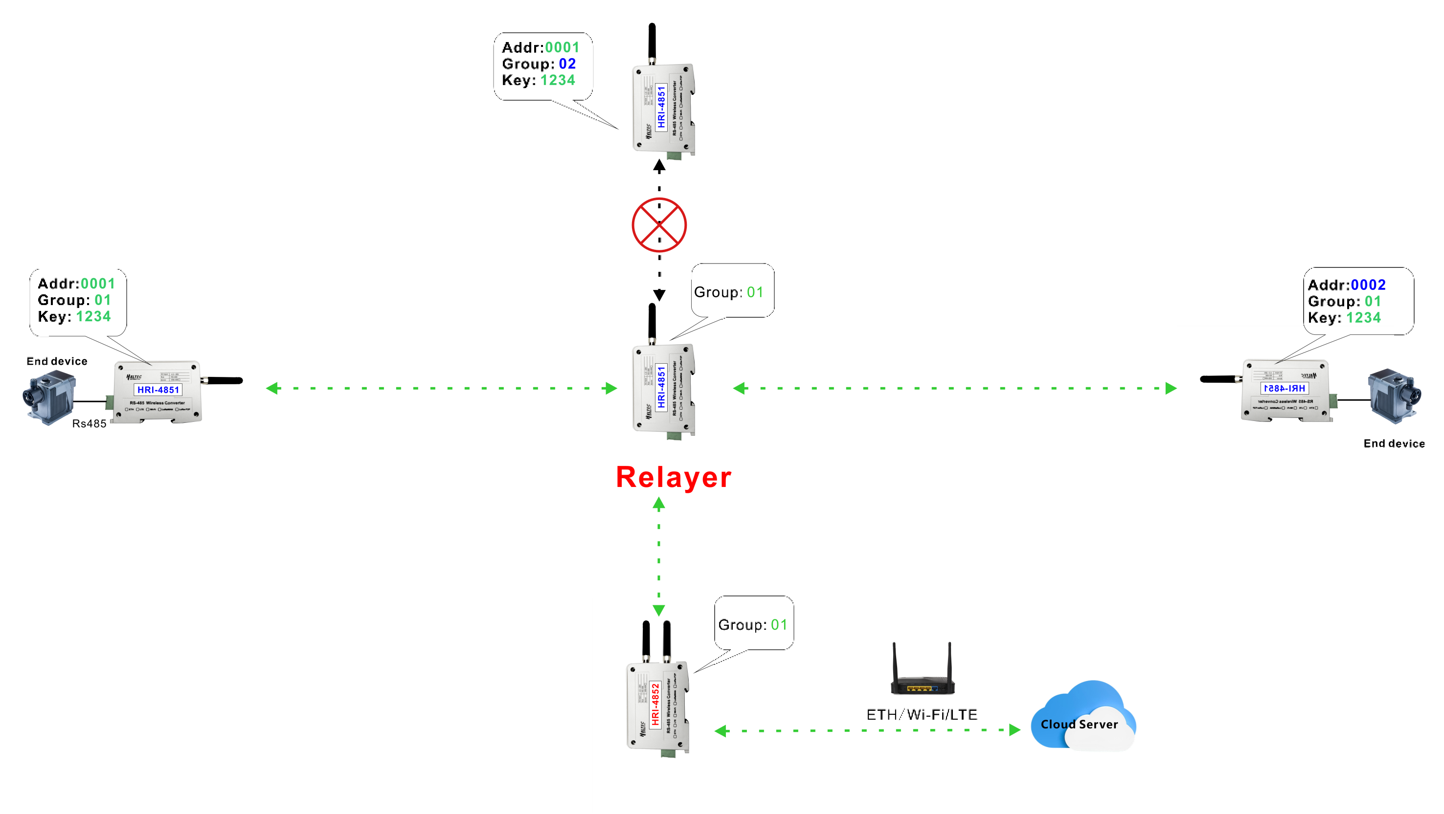

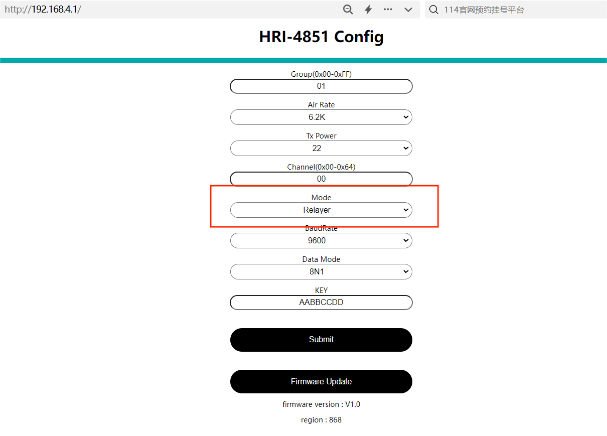

HRI-4851 Relayer
The HRI-4851 can realize the relay function, and the two terminals of its connection can be either the HRI-4851 or the HRI-4852.
Enter the configuration page of HRI-4851, select Relay in the Mode option, and then configure its lora parameters and Group to be the same as the two terminals.

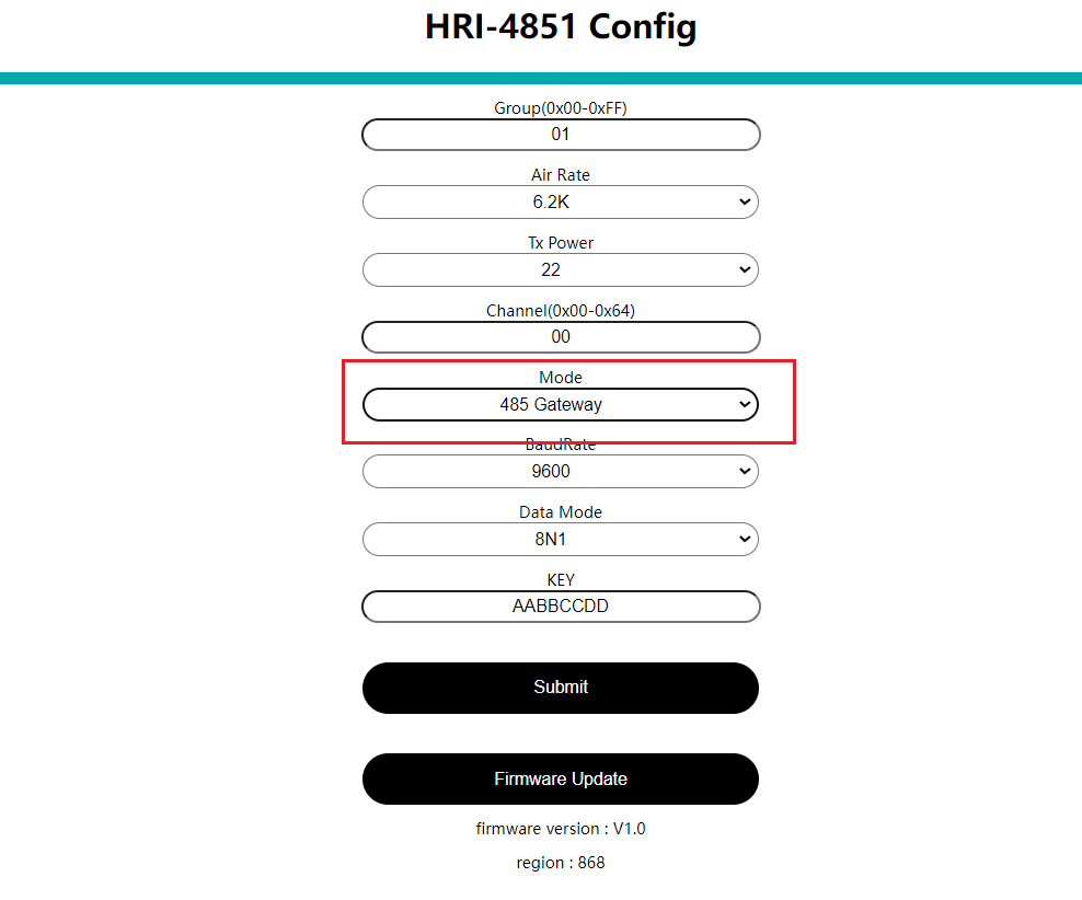

HRI-4851 Gateway

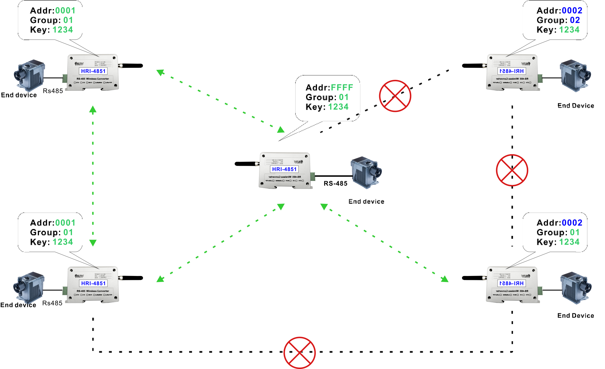

When HRI-4851 is in gateway mode, it can communicate with all HRI-4851 in the same Group.
This feature does not connect to a server, but is available directly in the terminal.
Enter the configuration page of HRI-4851, select Gateway in the Mode option, and then configure its lora parameters and Group to be the same as the two terminals.
