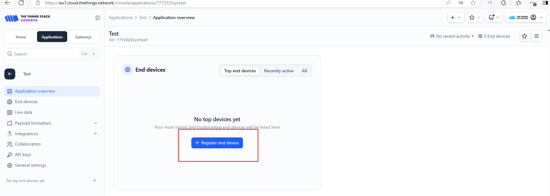

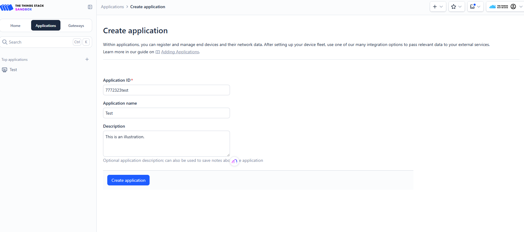

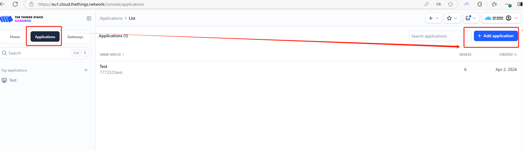

Go to the server page and click Application->Add Application.
Create an Application. You can fill in any information you want. This is a description of your project.

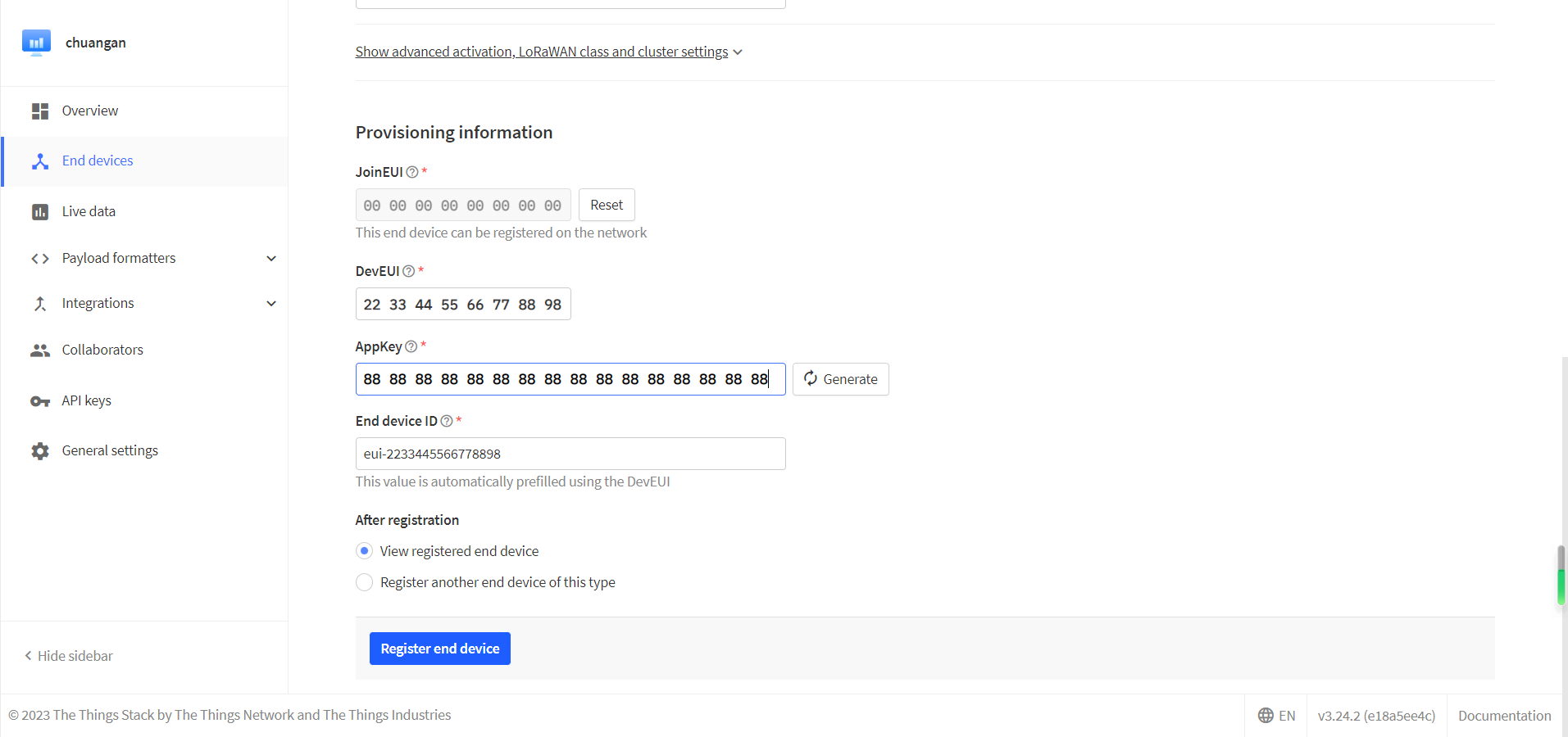

Click Register end device

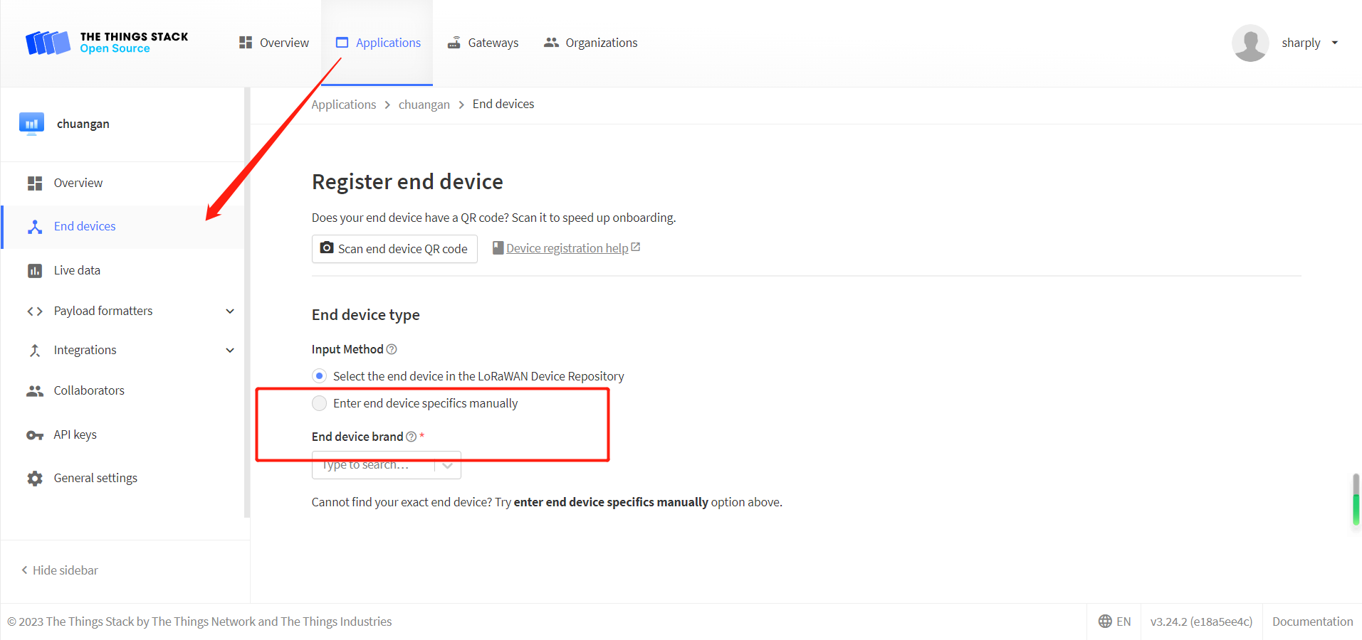

Register a new device in TTN or TTS “Applications”,choose Enter end device specifics manually.

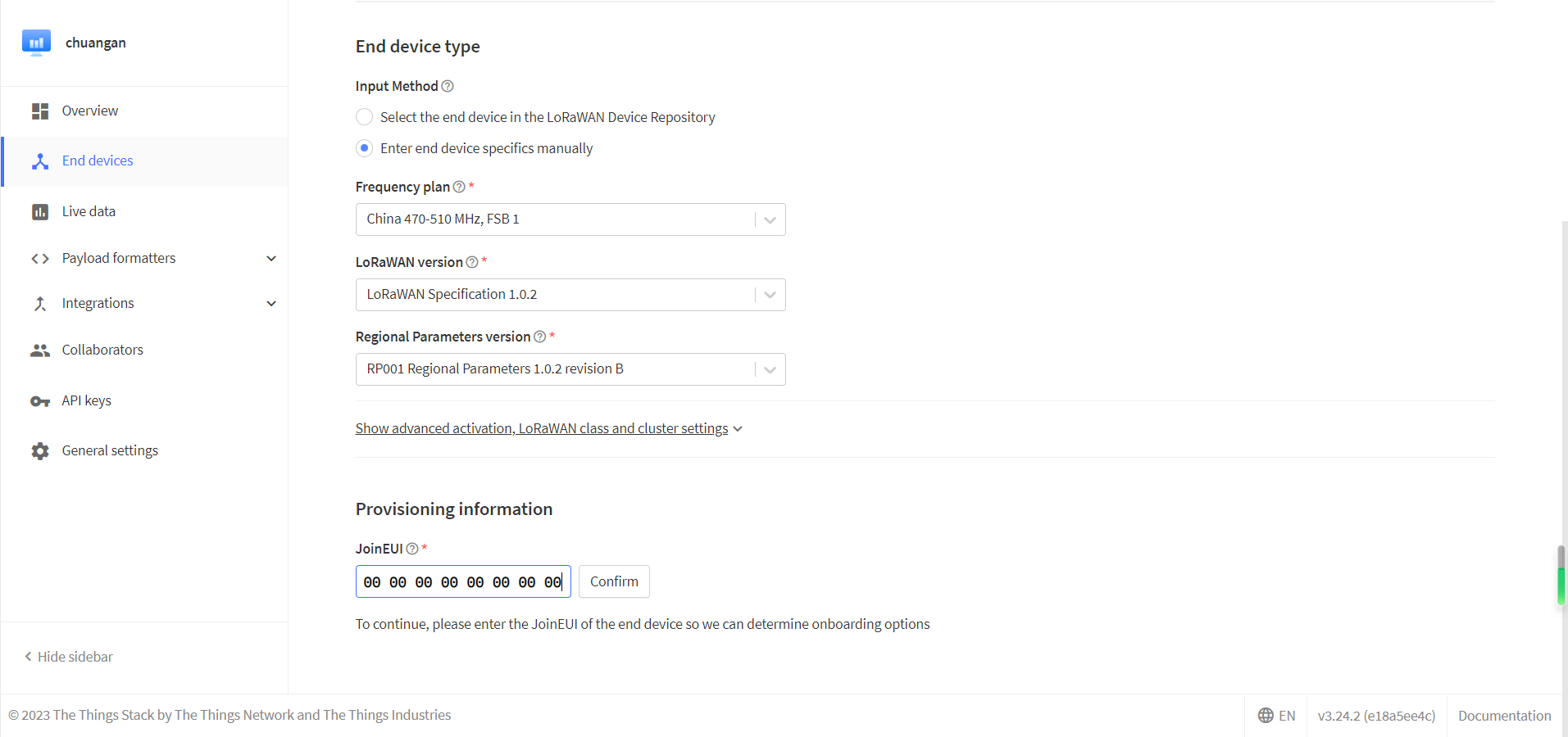

Select the frequency plan, and fill in the corresponding AppEUI, DevEUi, AppKey, and register the device.
小技巧
The joinEui here is the AppEui on the configuration page, which is “0000000000000000”.

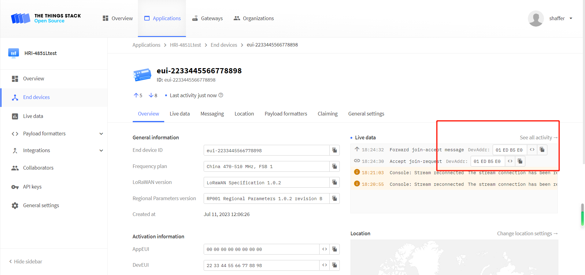

After registration is complete, if all is well, you will see the device active.

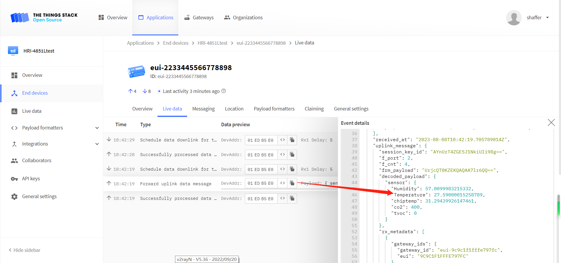

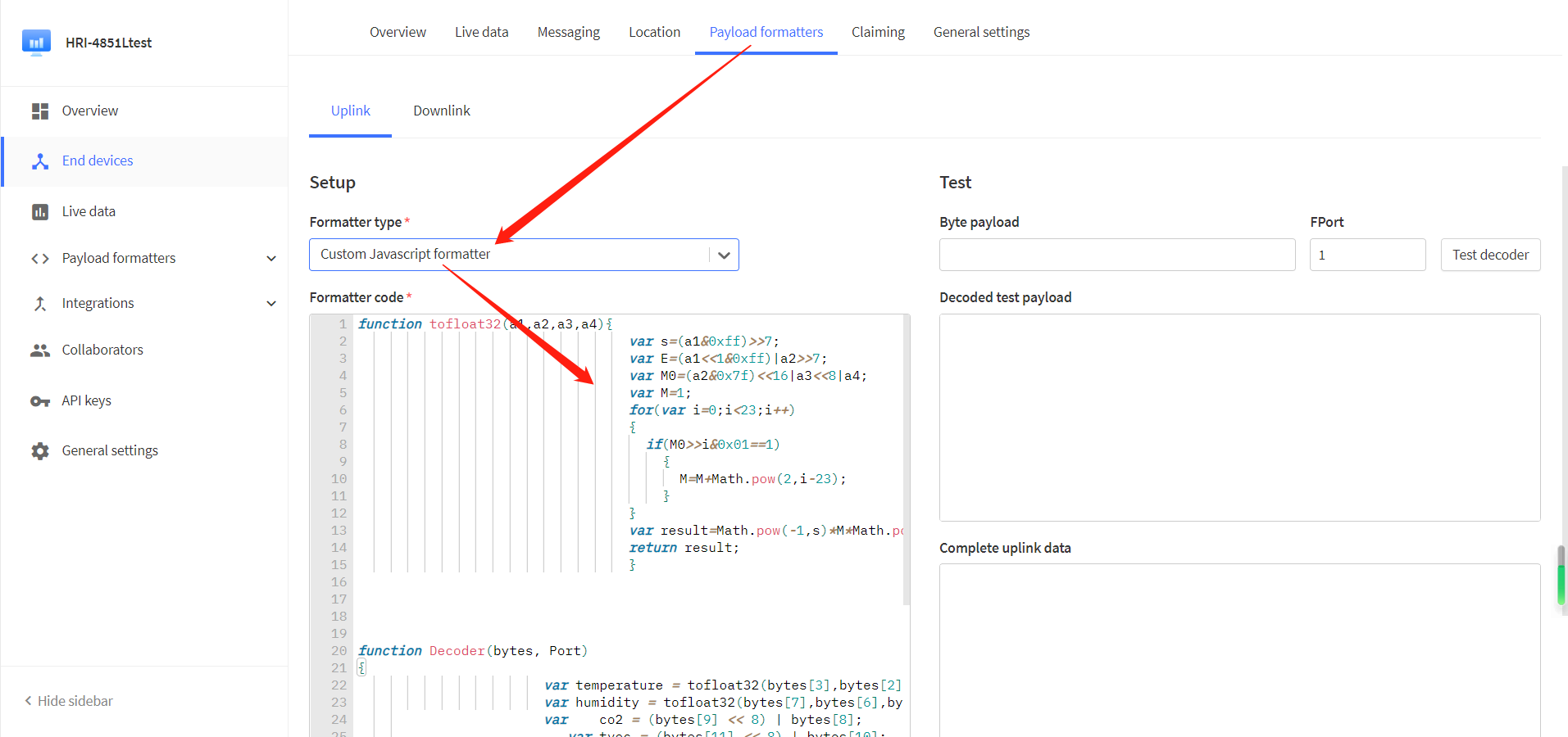

Click payload formatters, select Custom Javascript formatter, and enter decoding at the position in the figure. Download the decoder here: HRU-3601 Related Resources.
Click Save change and move the mouse to the uplink data output to view the data uploaded by HRU-3601.

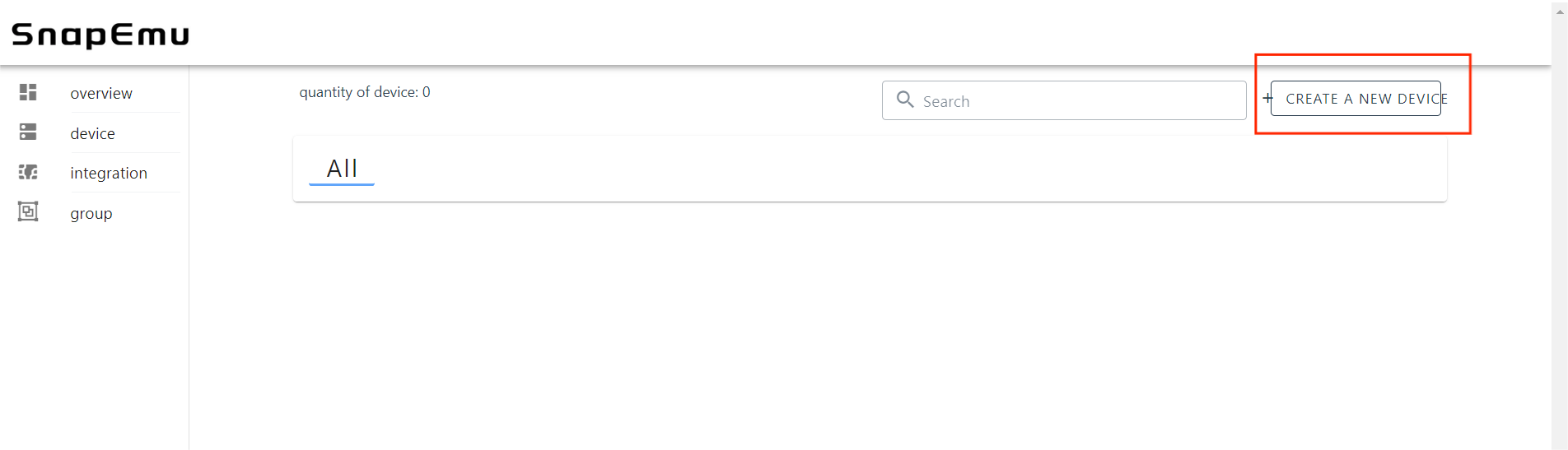

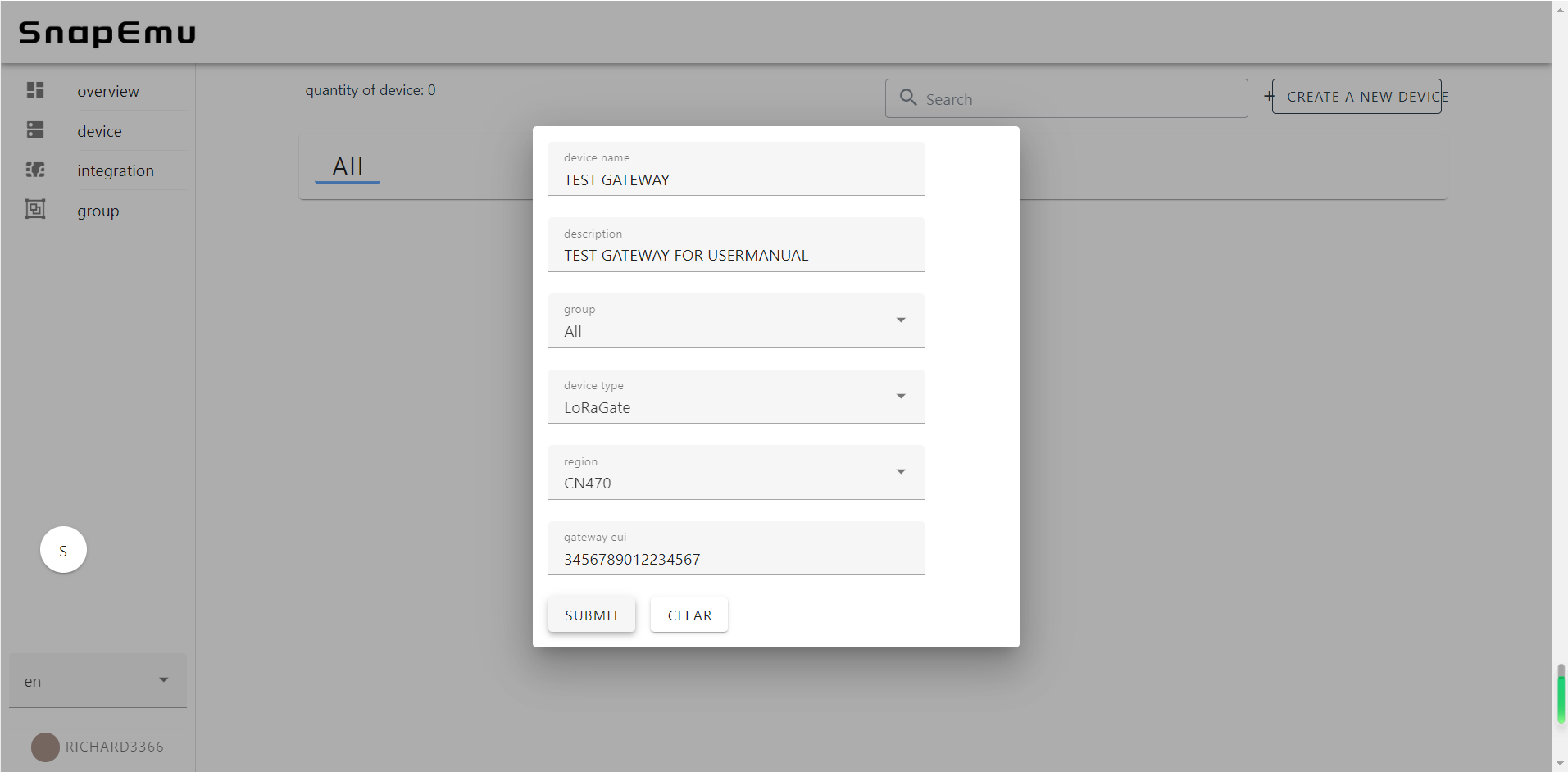

Connect to SnapEmu
Log into your account on platform.snapemu.com, click device, CREATE A NEW DEVICE.
If you’re using an APP,click + ,select input.
Fill in the device information.
