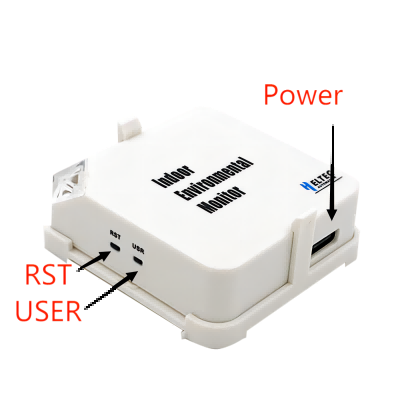

Power on
Connect the adapter through the USB port. You can also connect a 5V power supply directly via a USB cable.
Enable device status
Press the RST button, and the device indicator turns Green.
Then Press the ‘USER’ button, the RGB turns blue. At this time, the device goes into configuration mode.

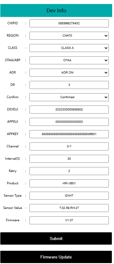

Enter Configuration Page
At this time, find the WIFi named HRU-3601-XXXX through PC or mobile phone, connect to it.
Enter”192.168.4.1”in your browser to navigate to the configuration page of HRU-3601.
Configuration
In the configuration page, you can modify the relevant parameters of LoRa.
  • Chip ID MCU chip ID, When you lose the device LoRaWAN license in some cases, you need to license through it.
  • REGION LoRaWAN operating frequency.
  • CLASS The working mode of the device.
  • OTAAA/ABP The mode of connecting network.
  • ADR Choose whether to enable rate adaptation.
  • DR When selecting ADR off, select a DR on which the device is working. This option is not valid when DR Is enabled.
  • Confirm Whether to enable uplink information confirmation.
  • DEVEui DevEUI needs to be consistent with the server.
  • APPEui appEUI needs to be consistent with the server, some servers are called “joinEUI”.
  • APPKey appKey needs to be consistent with the server.
  • Channel The channel of the corresponding frequency band. For example, if you want to use channel “0”, enter “0”, and if you want to use channels “0-7”, enter “0-7”.
  • Interval(S) Interval period of uplink information.
  • Retry Number of retransmissions after uplink message failure.
  • Product Product model number
  • Sensor Type Sensor Type.
  • Sensor Value Sensor values.
  • Firmware Firmware version.
小技巧
The above is the configuration page in OTAA mode. If ABP needs to be used, the configuration will be slightly different.
Once the configuration is complete, click Submit. Press the RST button.
