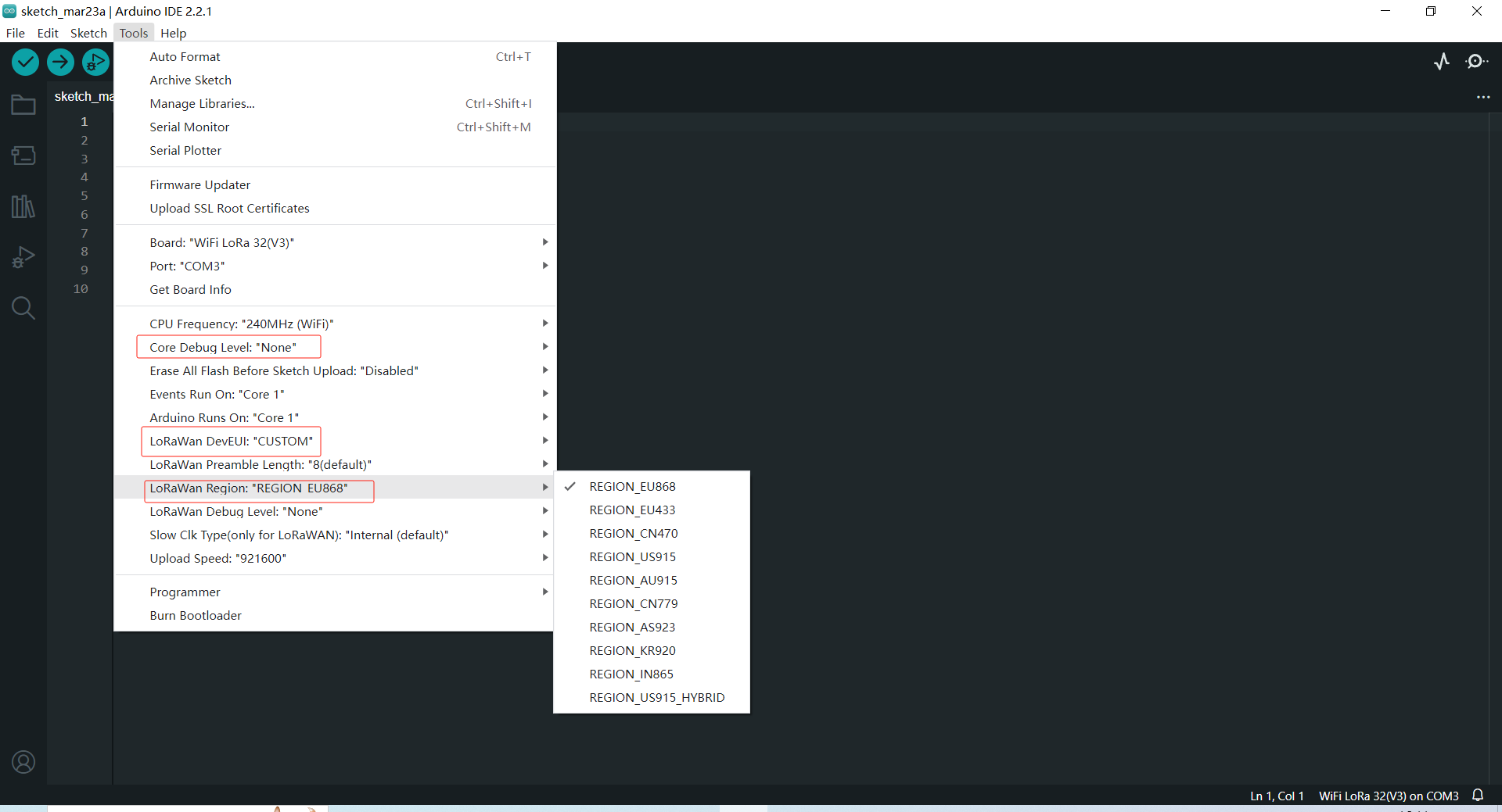

Configure Parameters
Connect the development board to the computer through USB data cable.
Open the Arduino and in the
Toolsoption, select the appropriateBoard,Port.
In
Toolsoption,Board,Upload Speed,CPU Frequency,Core Debug Level,PSRAMare ESP32 chip’s normal option, just keep default. Special notice theLoRaWan Region,LoRaWan Debug Level,LoRaWANDEVEUI.
LoRaWan Region – LoRaWAN protocol region definition, strictly follow LoRaWAN™ 1.0.2 Regional Parameters rB;
LoRaWan Debug Level – Messages printed via serial.
None – Default;
Freq – Uplink/downlink frequency;
Freq && DIO – Uplink/downlink frequency and DIO interrupt information;
Freq && DIO && PW – Uplink/downlink frequency, DIO interrupt information and low power status.
LORAWAN_DEVEUI – LoRaWAN Device EUI generate method
CUSTOM – Defined by the user in the DevEui array of the code, 8 bytes;
Generate By ChipID – Generated according to the Chip ID of the chip. Selecting this option will override the setting in the DevEui array in the code.
