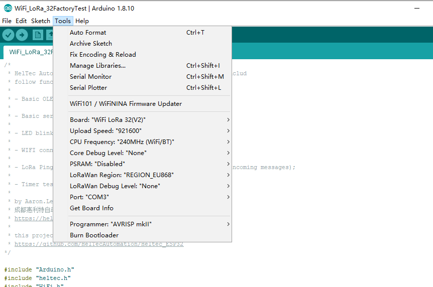

  2. Open Arduino IDE, Correctly select a board and relevant options in the Tools menu:

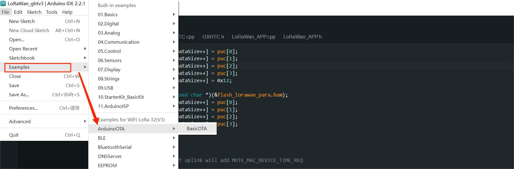

  1. Then select an example.
  1. To execute the code in a library, you need to mouse over, scroll down, find the library, and find the code in it.

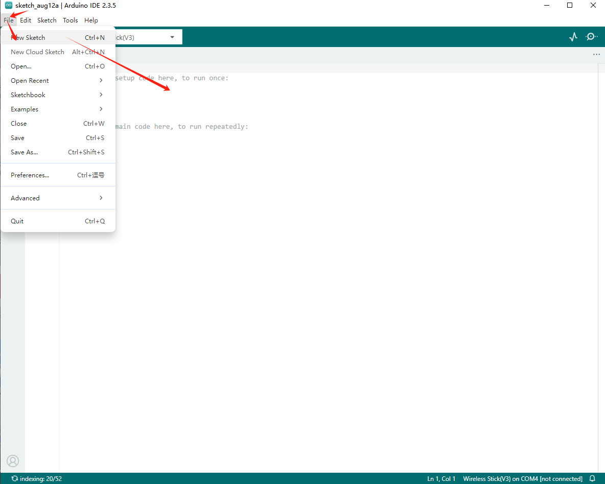

  1. Programming
  • New sketch
  • To execute the demo in the heltec ESP32 library, you need to mouse over, scroll down, find the library, and find the code in it.
