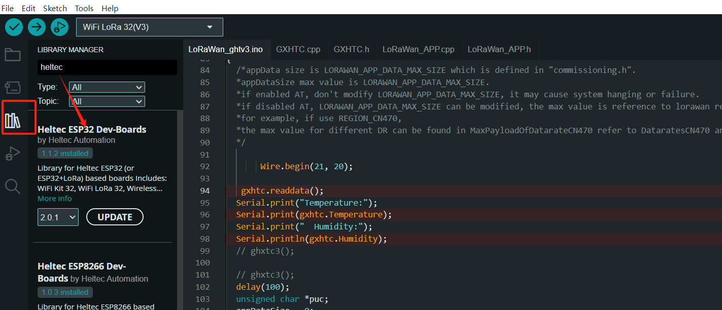

Click Tools --> Board --> Boards Manager..., search Heltec ESP32 in the new pop-up dialog, then select the latest version and click install

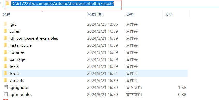

Via Local File
Download the development environment. https://resource.heltec.cn/download/tools/WiFi_Kit_series.zip

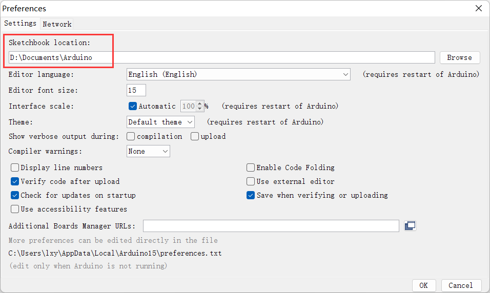

Open Arduino IDE, and click File->Peferences.
Go to the folder in the red box.

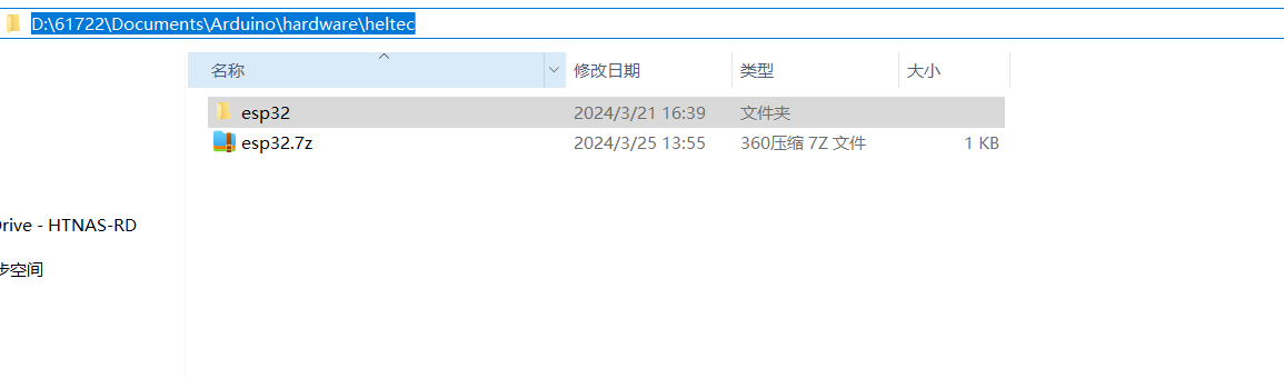

Create a new “hardware” folder in the Arduino folder. If there is already a “hardware” folder, you don’t need to create a new one.
Go to the “hardware” folder and extract “WiFi_Kit_series” into this folder.
Go to the “WiFi_Kit_series” folder, refer to the figure below to confirm whether the path in the red box is correct.
Restart the Arduino IDE to confirm whether the development environment is installed successfully.

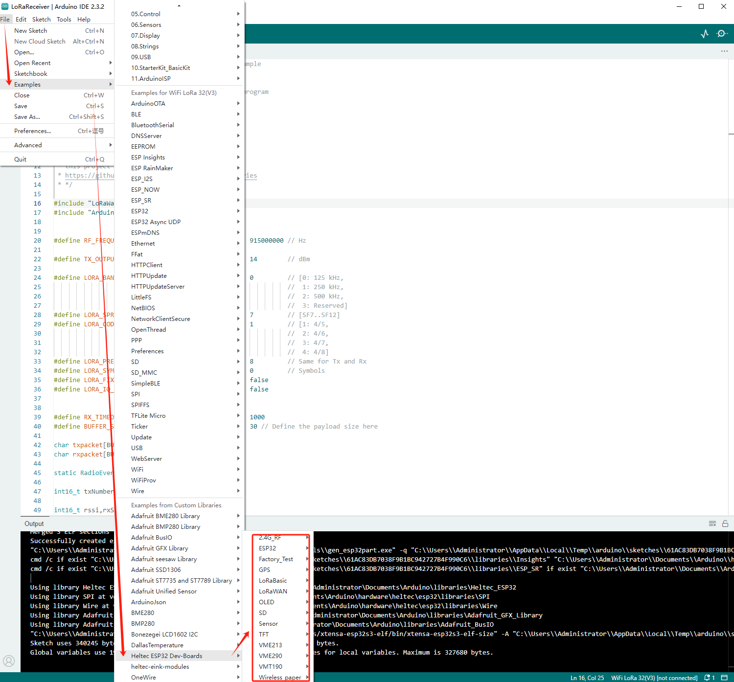

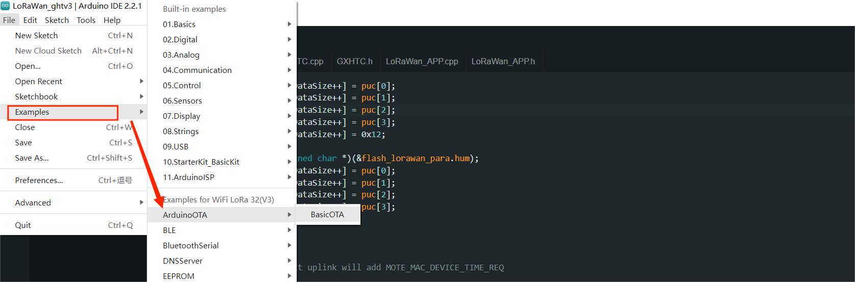

Select a demo example, compile and upload.
Execute an example
Correctly select a board and relevant options in the Tools menu:
Then select an example.

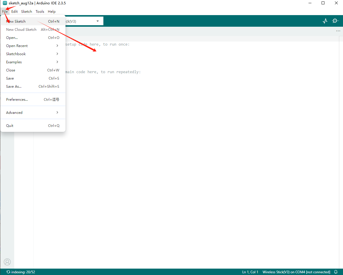

New a Heltec ESP32 program
Open Arduino IDE, create a new .ino file, then copy the below code.
