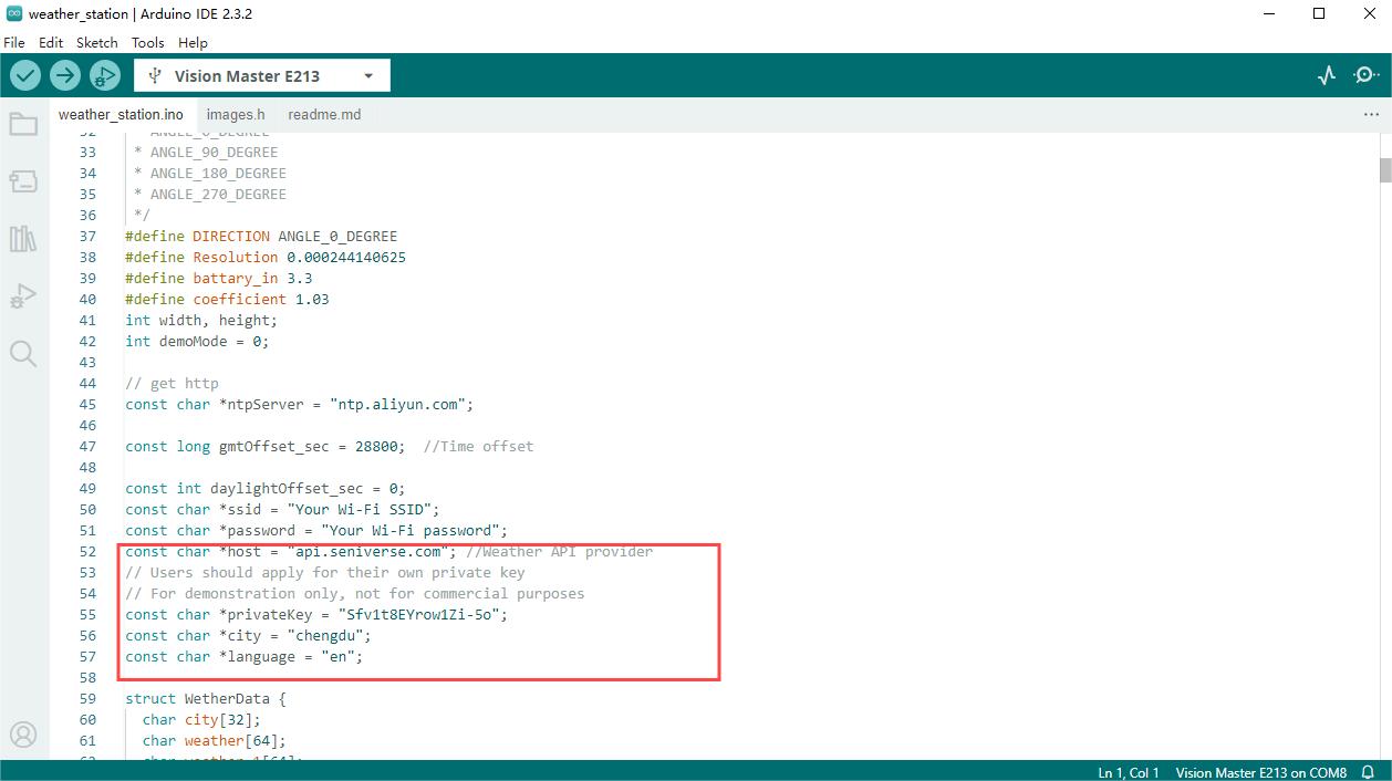

Weather Station
Github Link
This demo will fetch weather and time information over the network and print it to the device display.

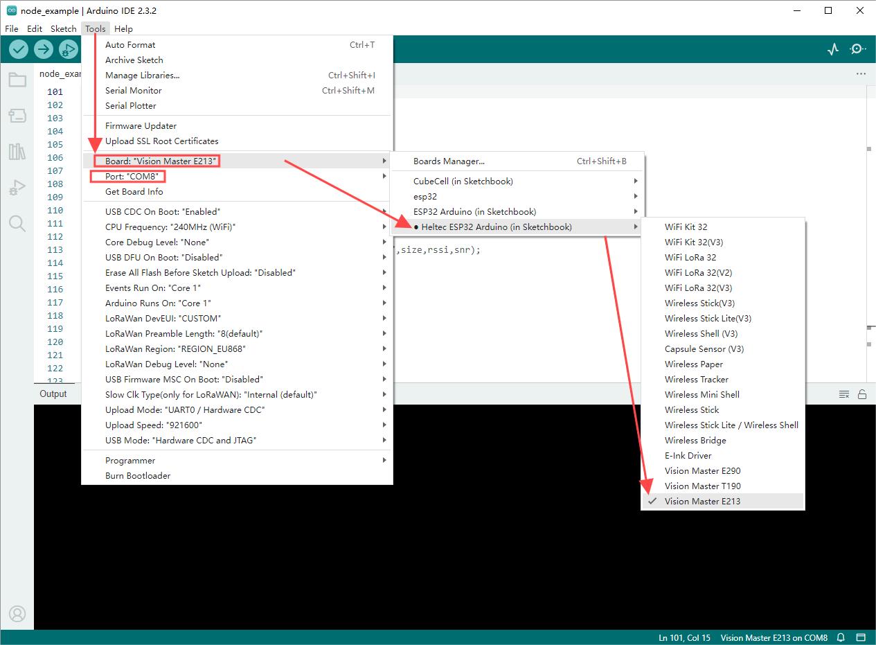

  1. Open the ArduinoIDE and select the appropriate board and serial port from the Tools menu.
  1. Follow the following path to select the example.
  2. In this code you need to fill in the available Wi-Fi.
    Warning
    If you don’t connect Wi-Fi, the display won’t work.
  3. The current code fetches the weather and time data through API of the corresponding website. If you want to change the data source, please refer to the Readme.md file of the code.
