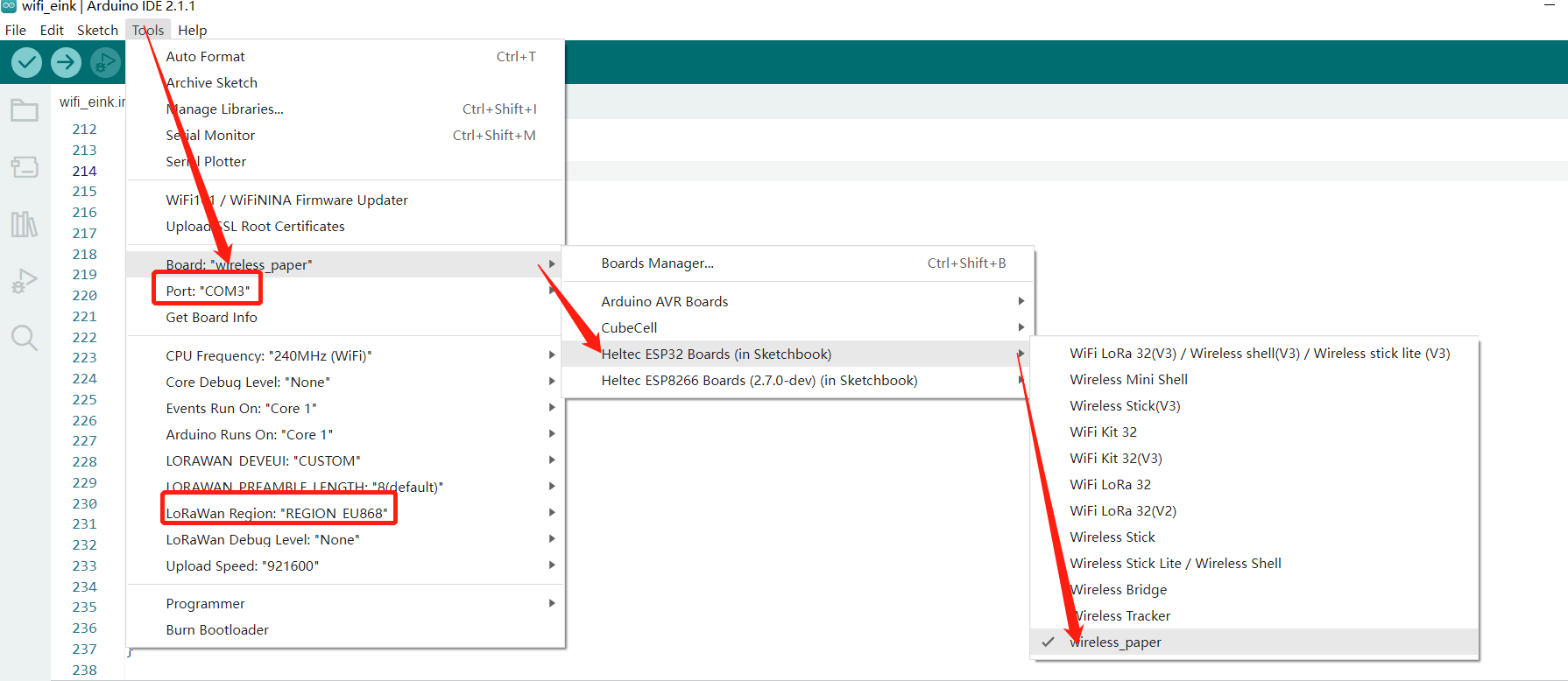

  • Connect the Wireless Paper to the PC using a TYPE-C wire. Open Arduino IDE, click Tool to select your development board, frequency band, port and other options.
