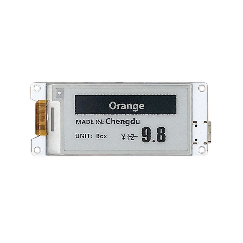

This topic aims to describe refreshing the Wireless Paper by downloading the program through the USB interface.
Image coding
Tip
This screen does not support grayscale, so when making the image, you will need to convert it to a pure black and white image smaller than 250X122.

Click upload, when the program is uploaded, the image is displayed on E-Ink.
