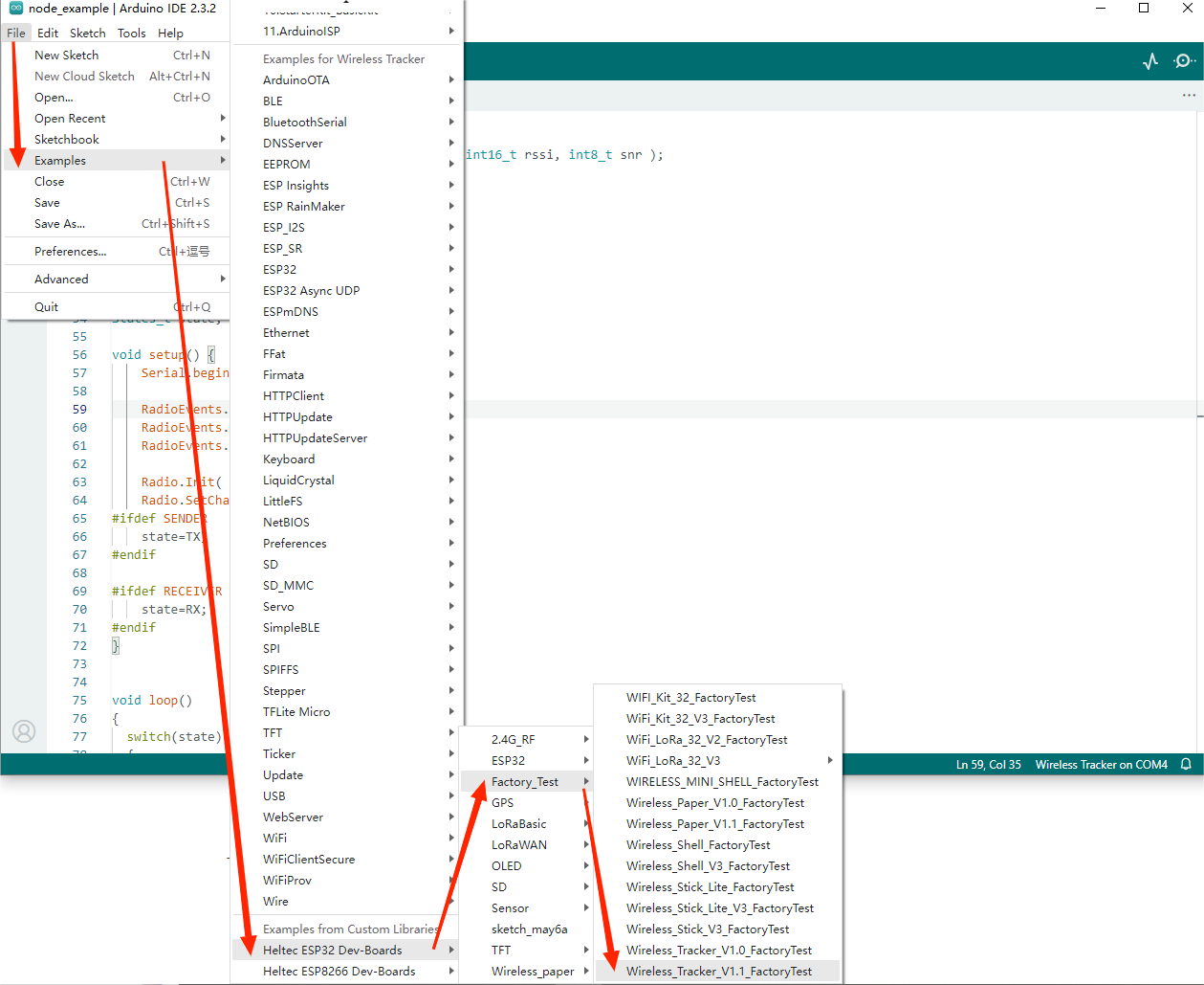

  1. Open Arduino IDE , click tool, selmodel, port, RF parameters, etc. As shown below
  1. Follow the path below to find the program and upload it.
