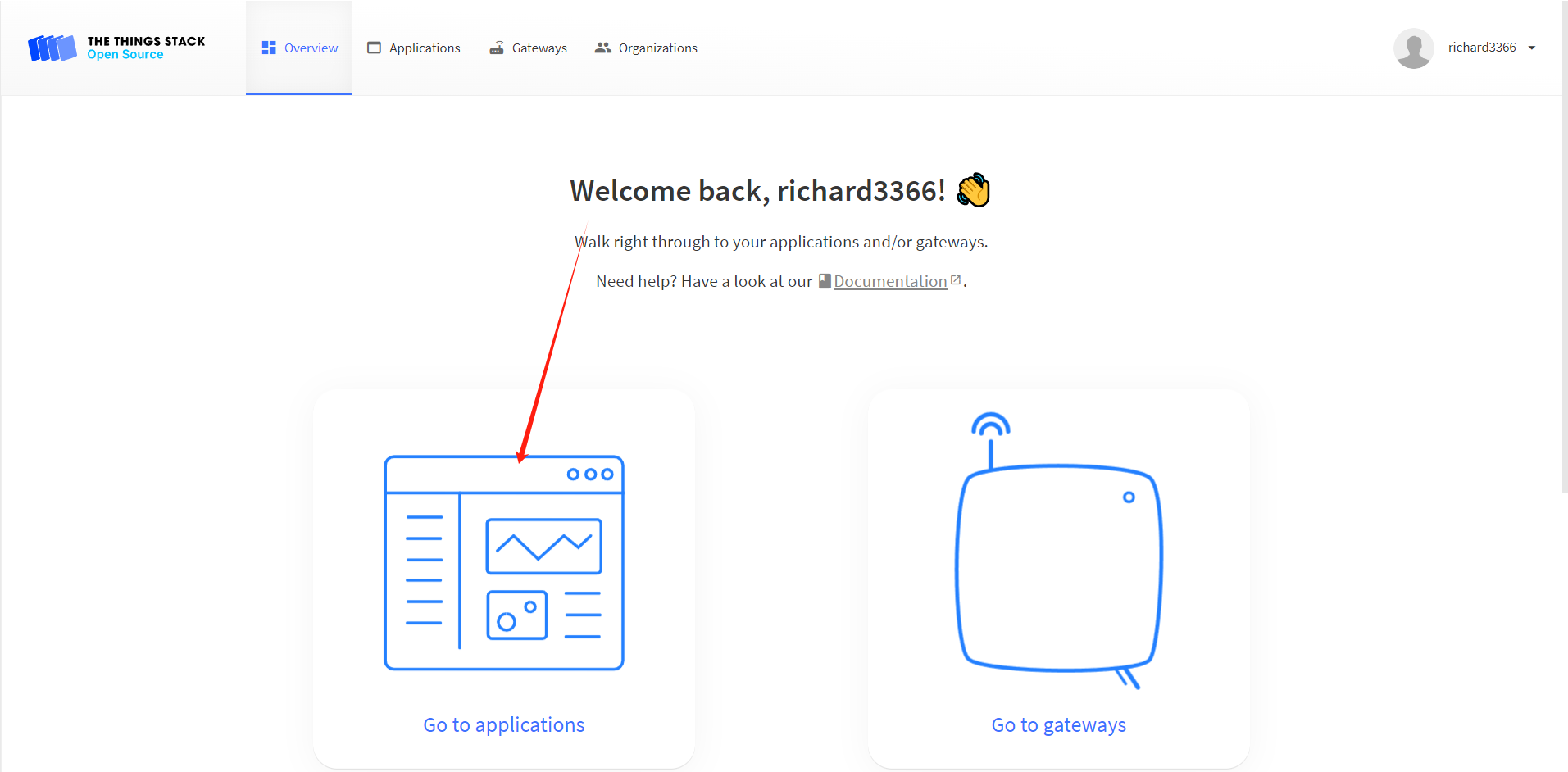

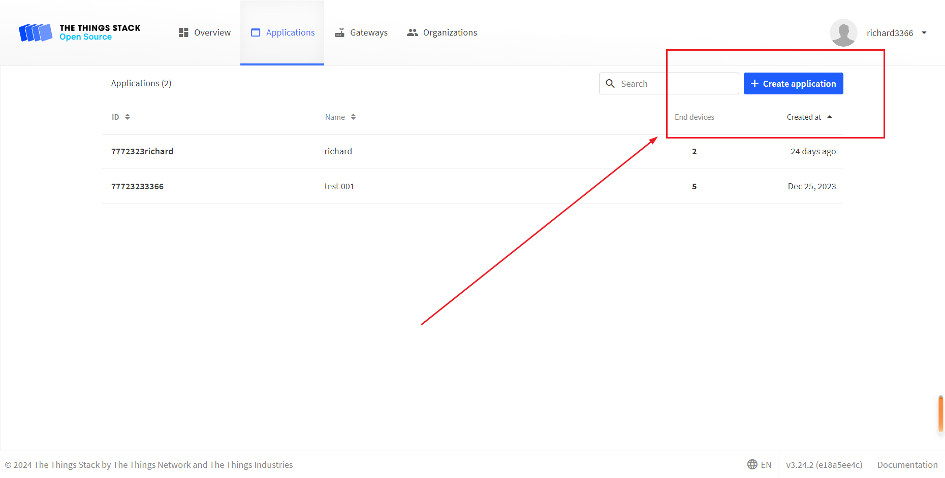

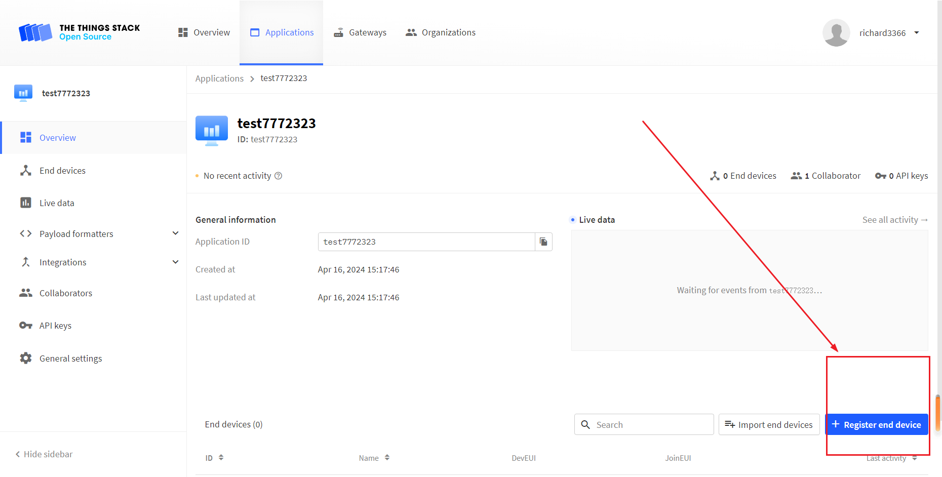

  1. Log in to the TTS server web page, register a new “Applications” .

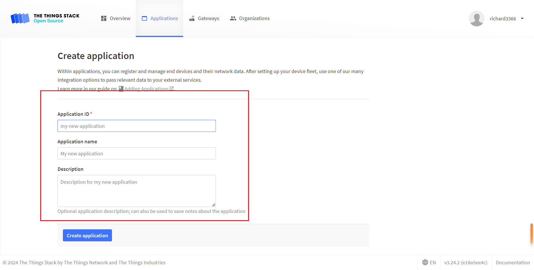

  2. Create application
  1. You can freely fill in the Application information in the red box, and click Creat application when you’re done.
  2. Register an end device.

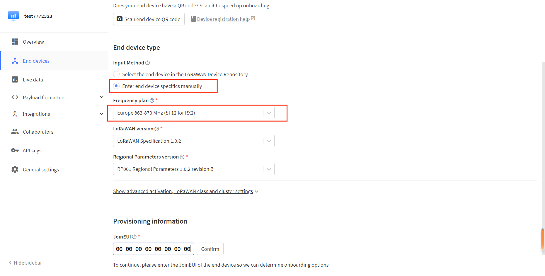

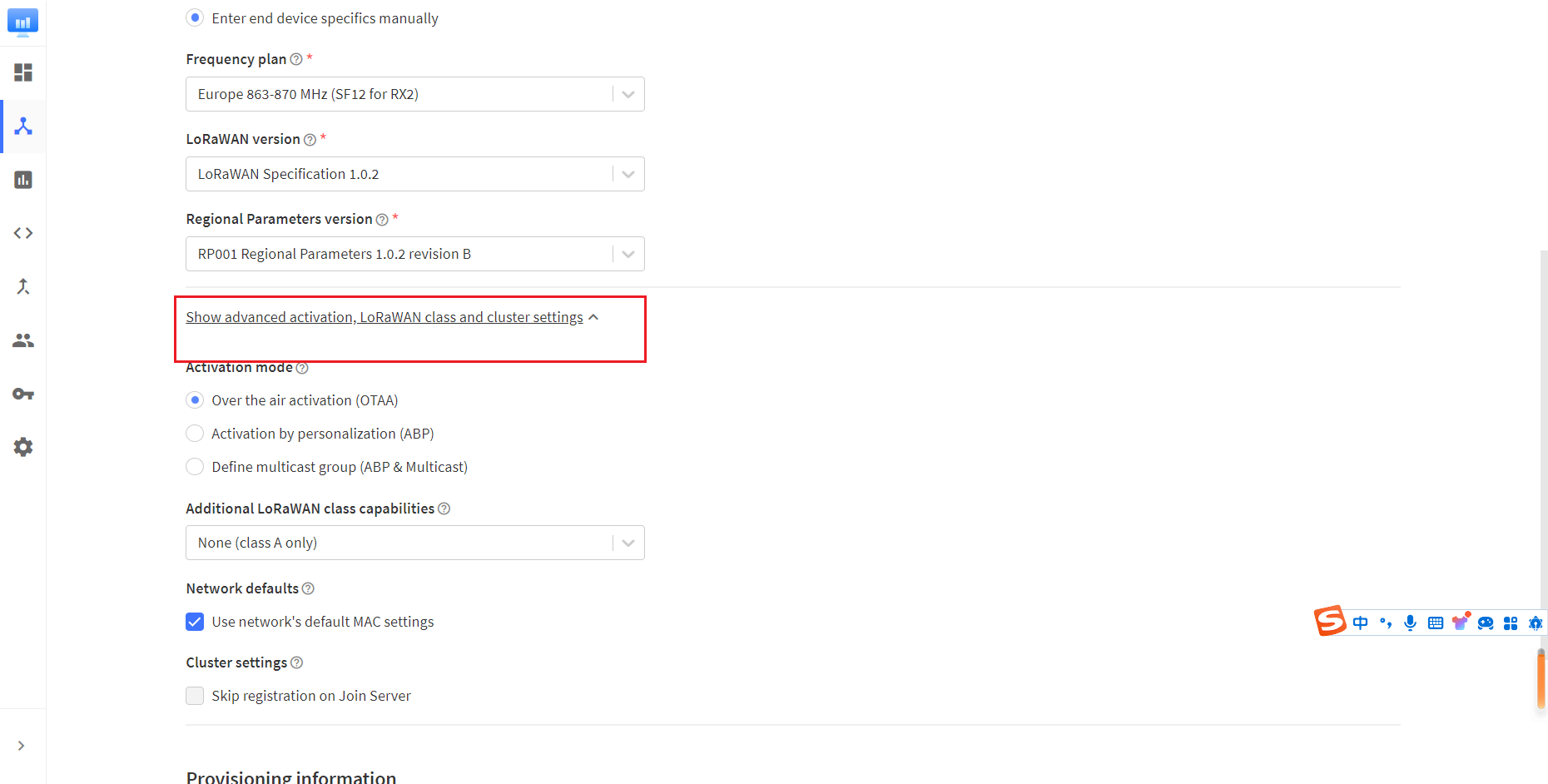

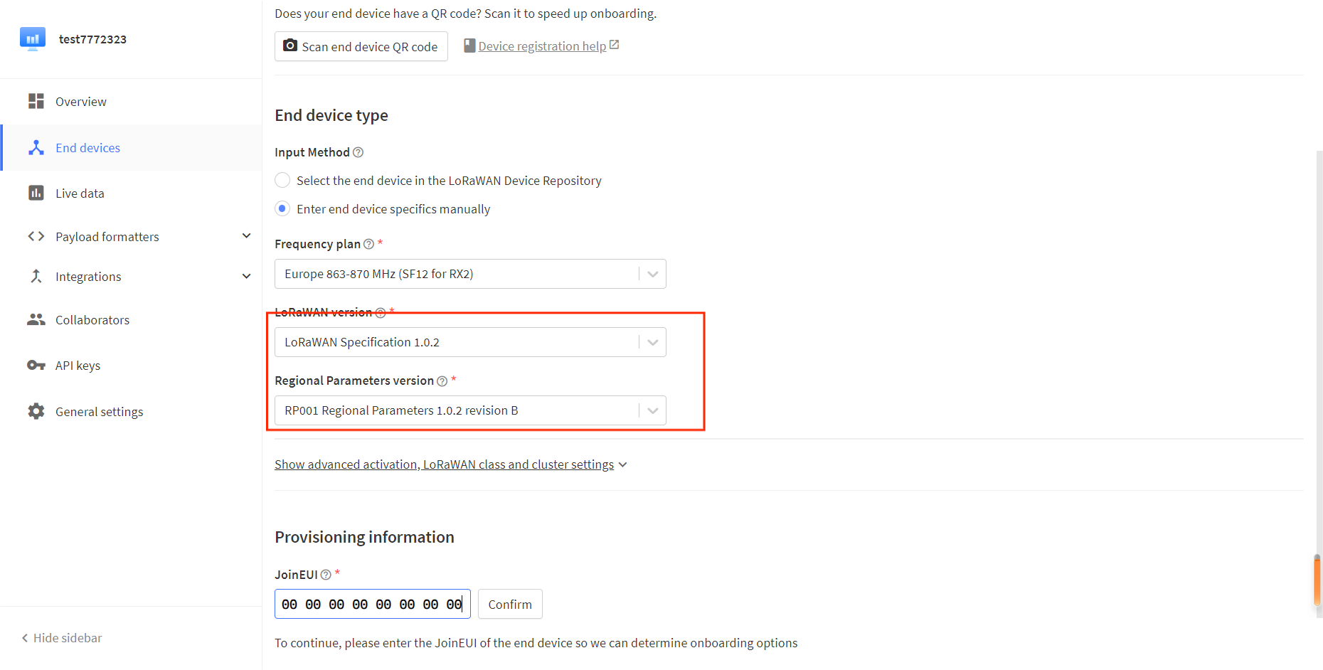

  3. Choose Enter end device specifics manually, Select the frequency band corresponding to the node,
  4. The LoRaWAN version is chosen to be 1.0.2 B

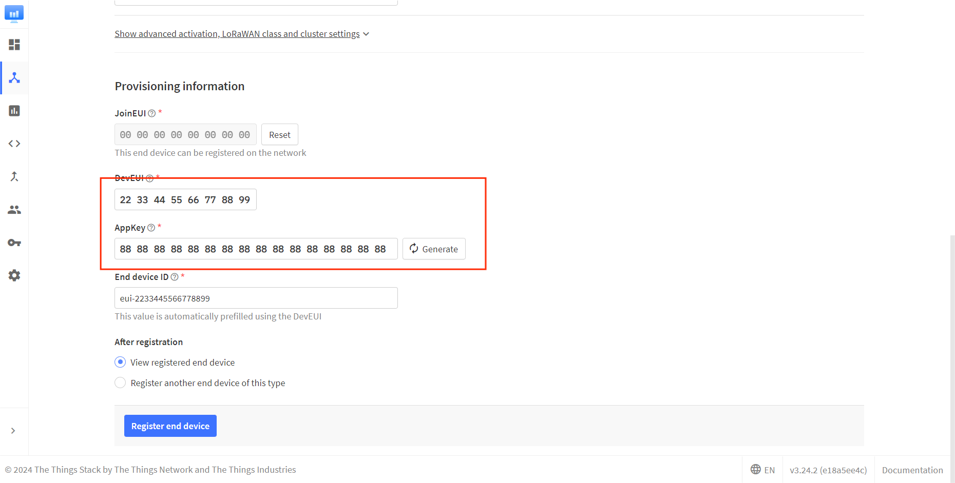

    The Show advanced activation, LoRaWAN class and cluster settings option has some other LoRaWAN parameter Settings such as OTAA/ABP.CLASS A/C, these parameters default to OTAA and CLASS A, in general need to be consistent with the node Settings.

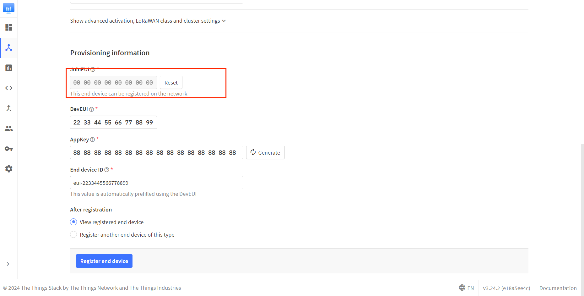

  5. Fill in JoinEUI and click confirm.
    Tip

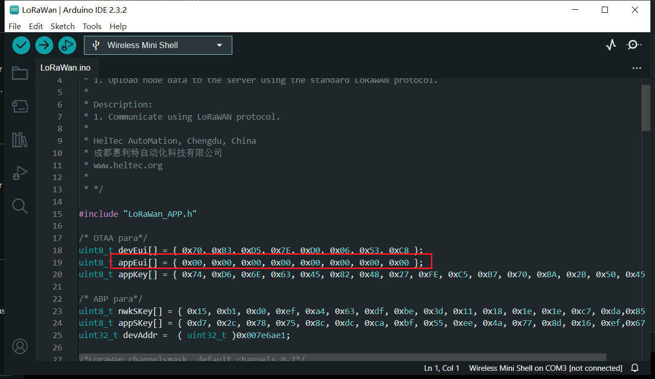

    In code or some application products, JoinEUI is represented as AppEUI.
  6. Fill in DevEUI and AppKey.
    Tip

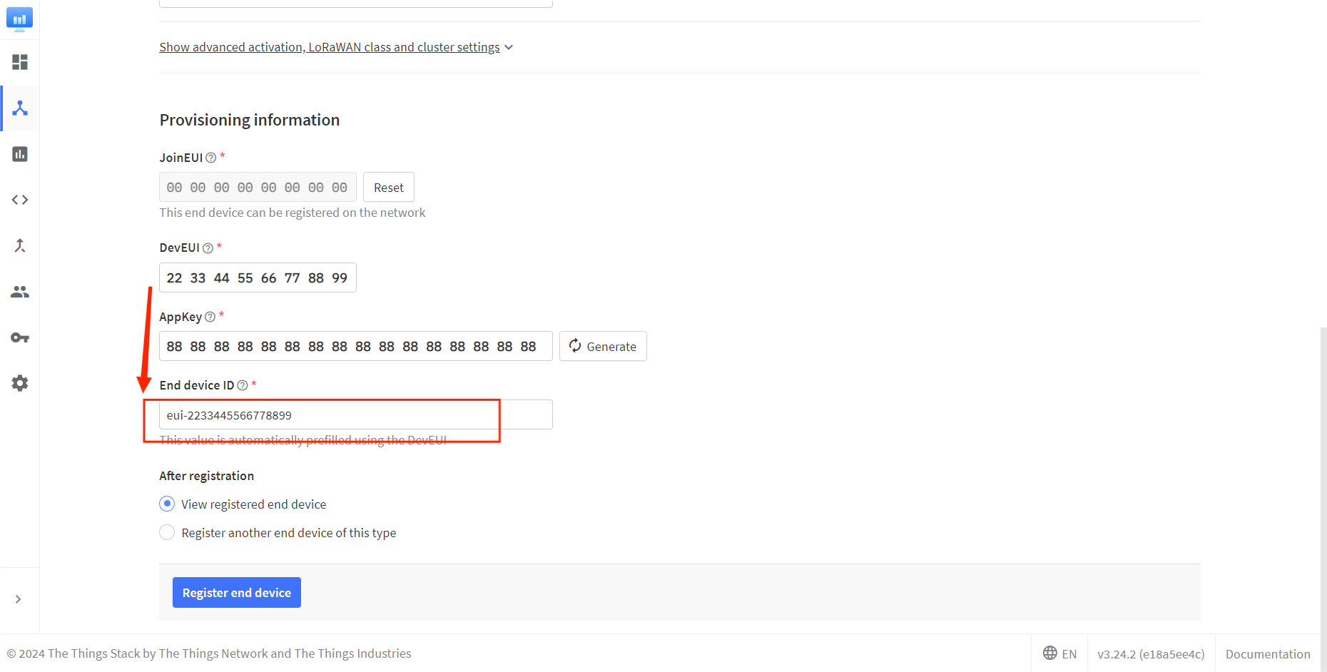

    The End device ID is automatically generated when you fill in DevEUI.

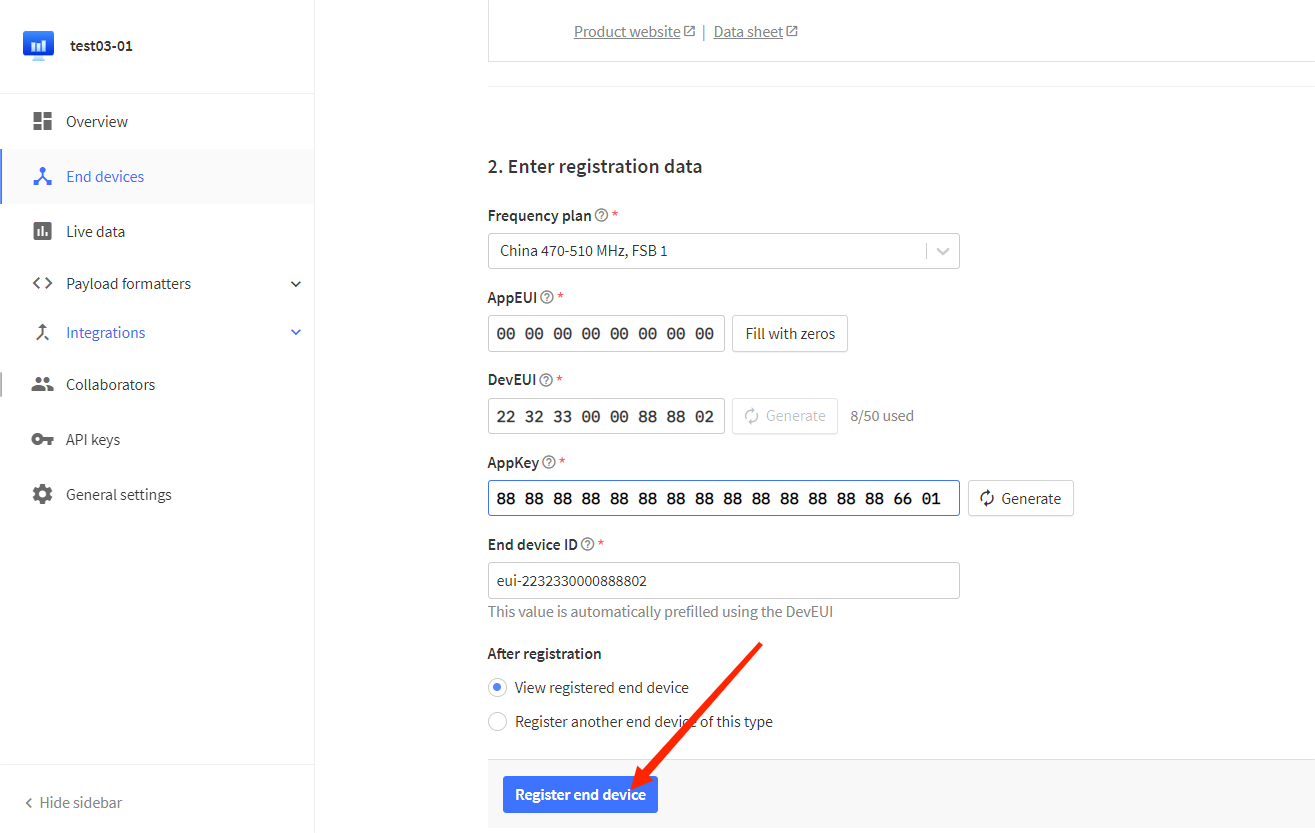

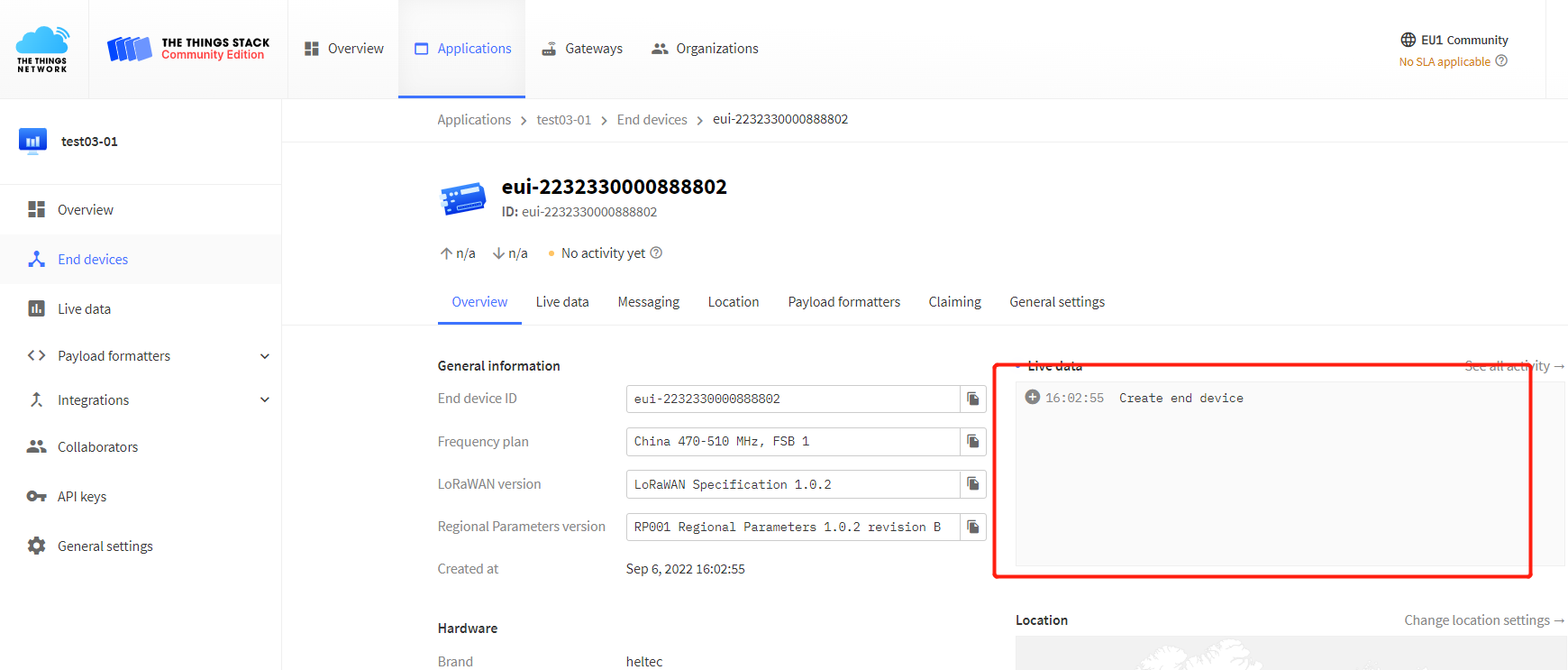

  7. Click to register.
After registration is complete, if all is well, you will see the device active.

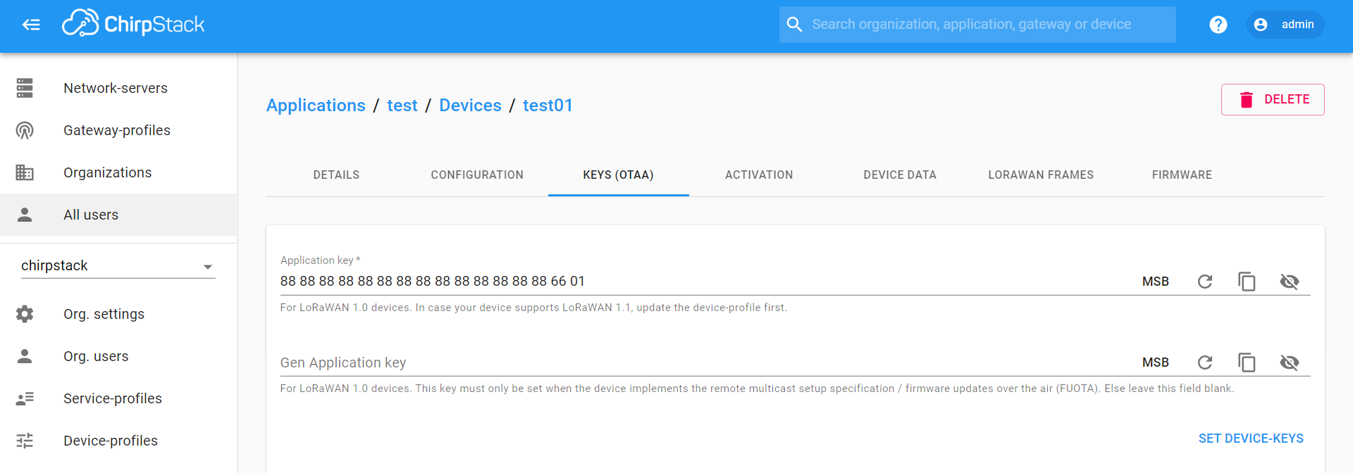

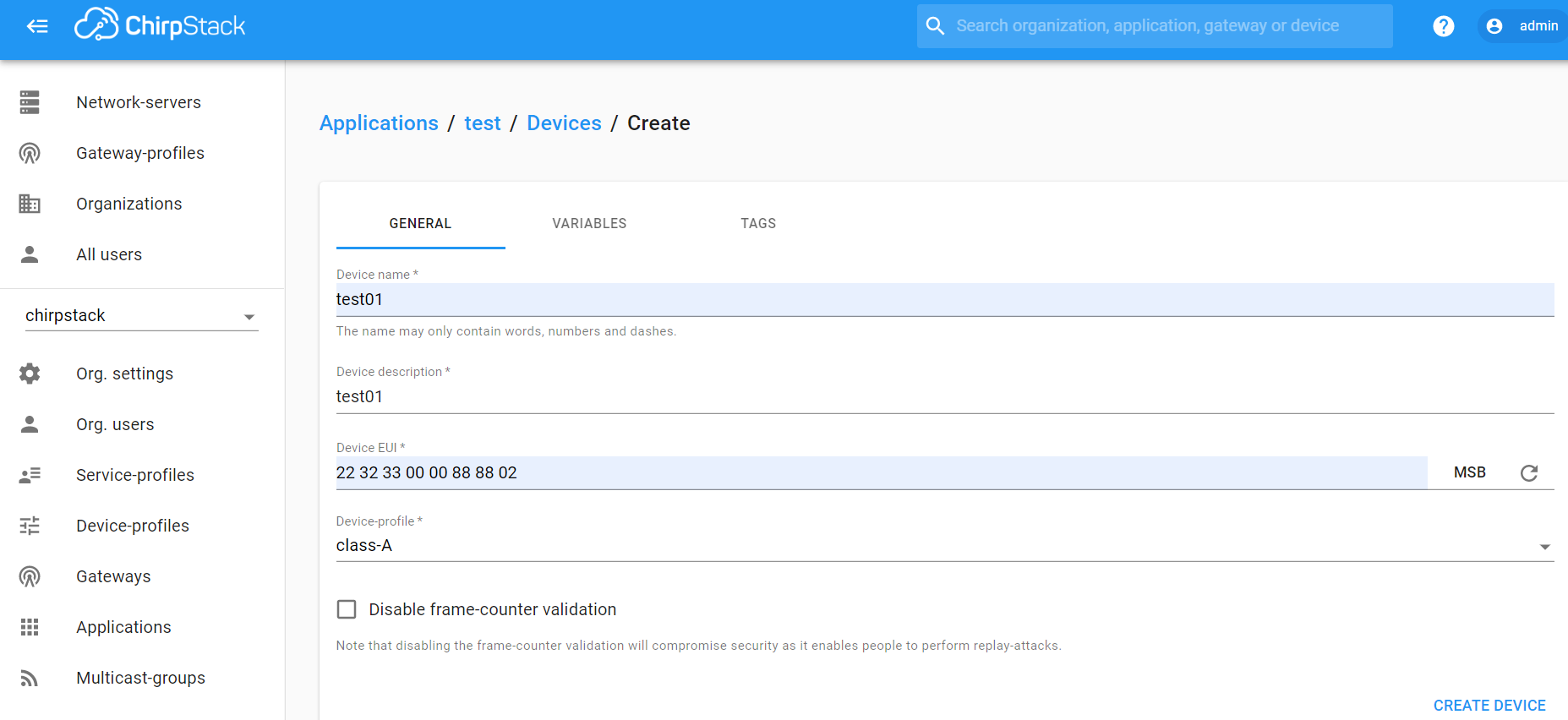

Register a new device in ChirpStack’s “Applications” page. Enter the device name, description, DevEUI. Select Device-profile.
Enter the Application key of the device.

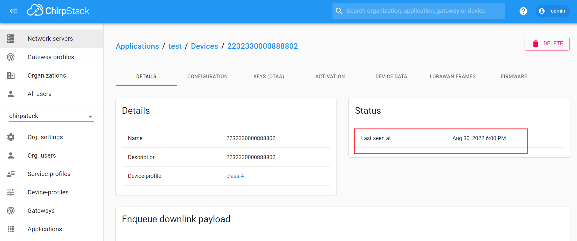

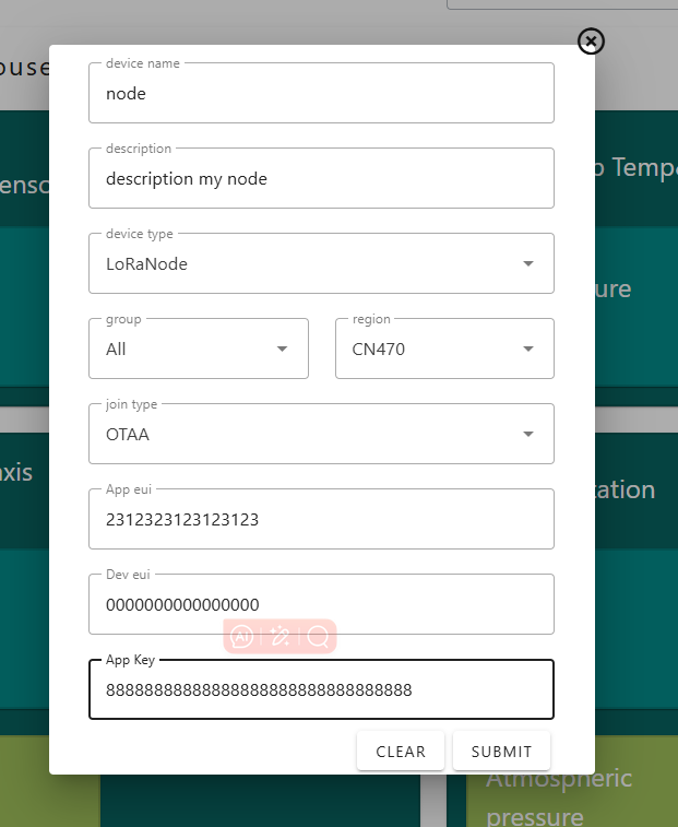

Manual registration on snapemu
Enter configuration mode to get device-related registration information.

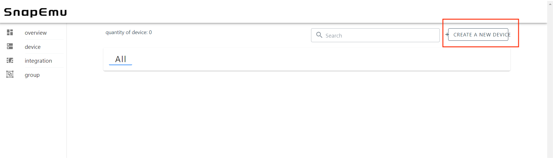

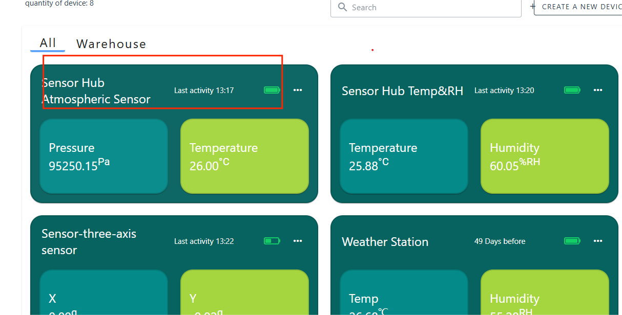

Log into your account on *platform.snapemu.com*, click device, CREATE A NEW DEVICE.
If you’re using an APP,click + ,select *input.*
Fill in the device information.
