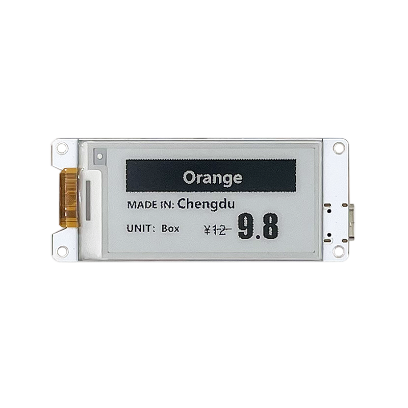

Click upload, when the program is uploaded, the image is displayed on E-Ink.
