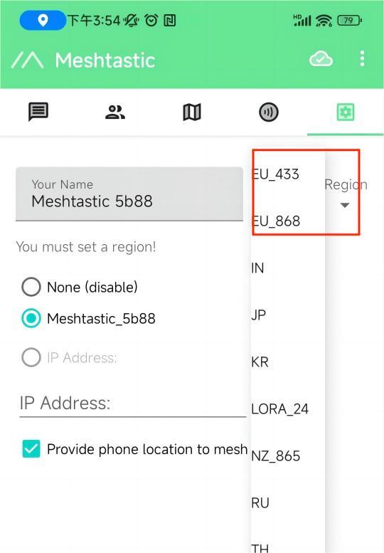

Set Regional Settings
In order to start communicating over the mesh, you must set your region. This setting controls which frequency range your device uses and should be set according to your regional location.

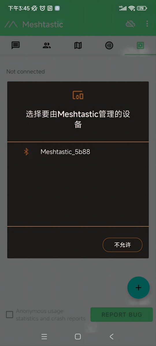

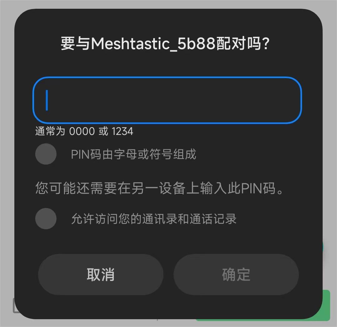

  1. Open the app, find your device via Bluetooth as shown below. Click to connect the device.
小技巧
If a window asks for a CAPTCHA appears, you need to look at your device’s screen. The default CAPTCHA for devices without a screen is usually 123456. If not, contact the firmware issuer.
  1. Once paired, Click “UNSET” next to the device name. Select the region from the list according to your regional location. Of course, your hardware must support this frequency band.
You can refer to this link for the relationship between LoRaWAN bands and regions:LoRaWAN_frequency_plans_by_country
备注
EU_433 and EU_868 have to adhere to an hourly duty cycle limitation of 10%. Your device will stop transmitting if you reach it, until it is allowed again

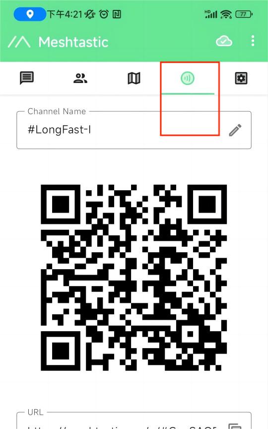

  1. Click the option below to select the channel you want to join。

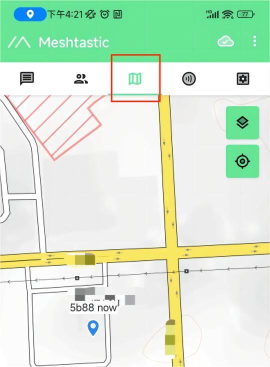

  1. The map option will be able to view the location information of the companion, which can be provided by the GPS module on the device, or by the phone to which the device is connected.

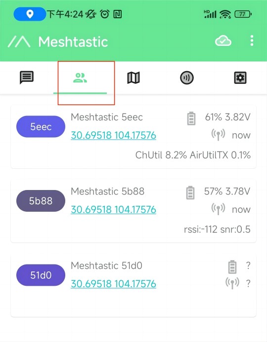

  1. The options below show some information about the companion device, such as latitude and longitude, signal strength, battery level, and so on.

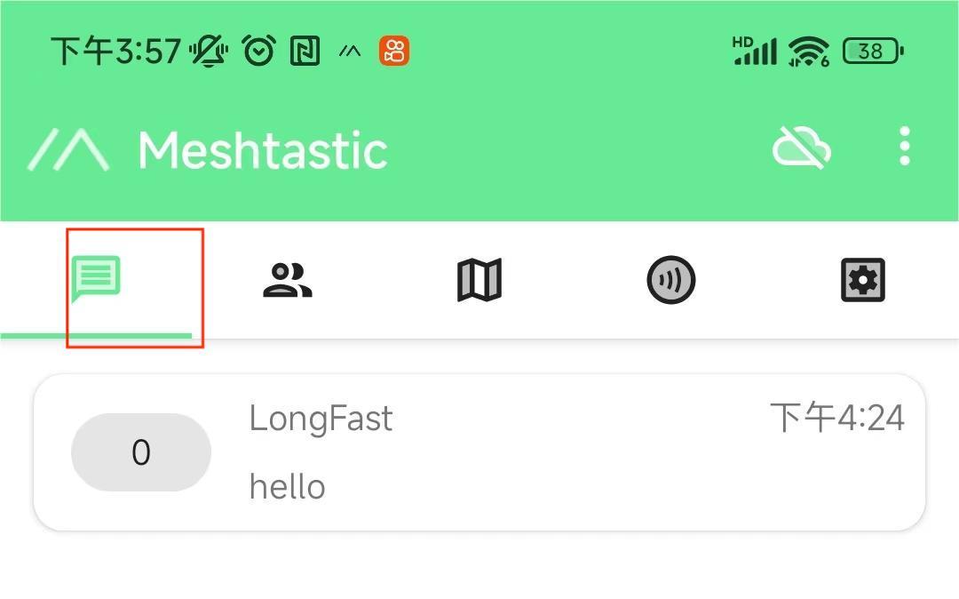

  1. This is where you’ll see the messages you want to send and receive, and they’ll be displayed on the device screen.

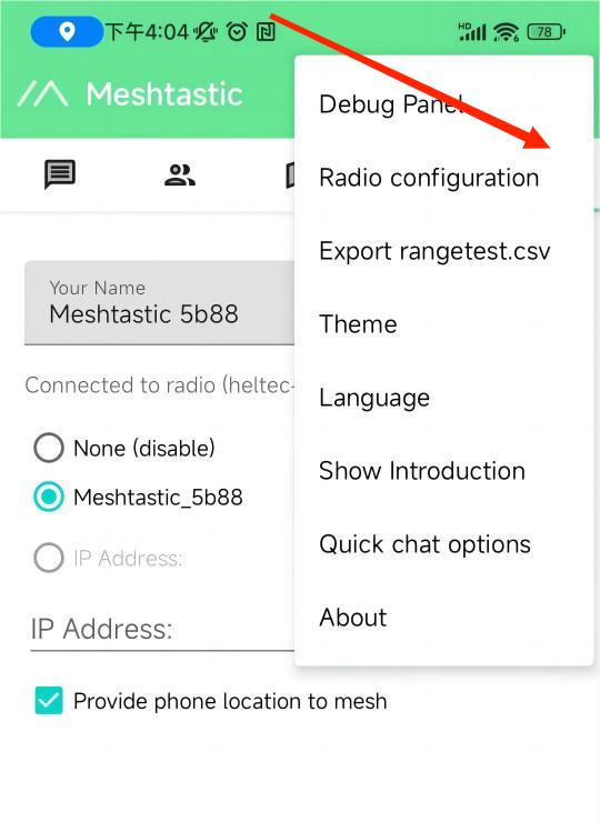

More Settings and usage
Click the top right button to see more configurable options.
