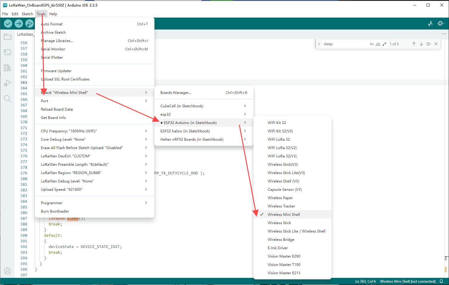

Program via Arduino IDE
  1. Open Arduino, select “Tools” ->”Board” ->”Wireless mini shell”
  1. Select the port.
  1. You can select the corresponding example in the sample library.
  1. You can also write your own code in the New Sketch.
  1. Click to Upload.
