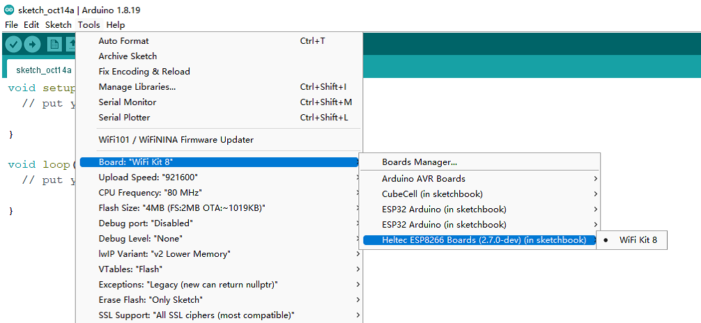

Click Tools->Board:->Boards Manager..., search Heltec in the new pop-up dialog, then click install.
The source code of Heltec ESP series (ESP32 & ESP8266) framework available here: https://github.com/Heltec-Aaron-Lee/WiFi_Kit_series

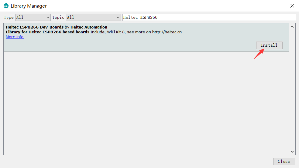

Step2. Download the Heltec ESP8266 Library
Open Arduino IDE, then Select Sketch->Include Library->Manage Libraries... Search Heltec ESP8266 and install it.
The source code of Heltec ESP8266 library available here:https://github.com/HelTecAutomation/Heltec_ESP8266

  • Select Wifi Kit 8 development board.
  • Select the corresponding example and upload.
