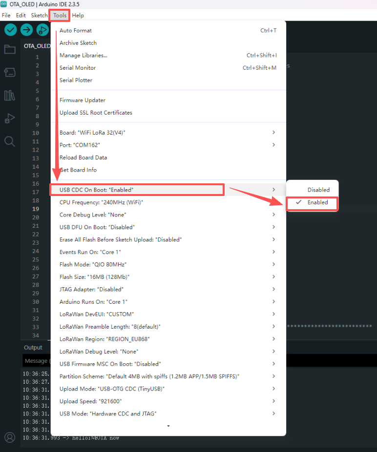

  1. To perform debugging via serial output, the USB CDC On Boot option needs to be Enabled in the tool.

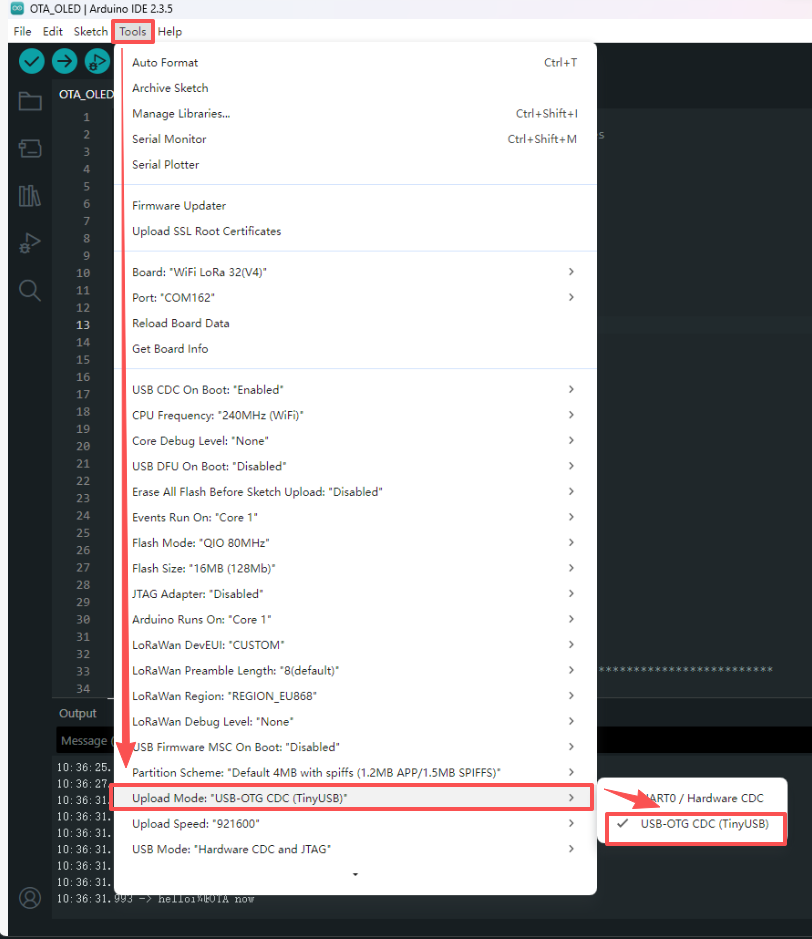

  1. And then set the upload mode to USB-OTG-CDC (TinyUSB).
This is a test program, can test that your board is functioning correctly.
